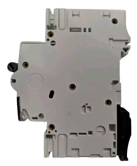

Was doing some testing and writing up what breaker types on the form and I couldn't find the EN number (sort of had a alarm bells about this, as under the impression that if you have a EN standard you would display it)
Just tried to Google the breaker to find one that wasn't incased in a board and found one on eBay but no EN markings as far as I noticed
Now I notice on this one there is a space at the bottom that Some Times has test.
But I figured if you where a maker , making to a standard you would display it proudly like a badge of honor

I think the point is without the EN number displayed it isn't a valid part, and most likely a snide. You can't just assume when you fill out a cert.
Good observation OP, bet it's one we could all easily overlook, especially with the current race to the bottom of manufacturers changing their subcontractors every couple of years resulting in disjointed looking carbuncle CUs. If you get the chance it'd be interesting to smash one open and see what's inside, given in the past snides have been found with nothing more than a switch mechanism and no overload/SC parts...

Not printing the en number might well absolve the retailer of claiming the part confirms to a certain standard, should a court of law point a finger. What's your defence?
Also, no one is claiming GEC is not legit; that is so far from what this thread is about I'm really not sure you're following. BTW one of pictured breakers is marked 60947 so your "simple to assume 60898" would be mistaken regardless of where some of them were sourced.

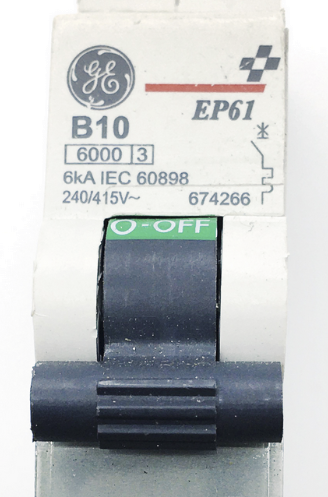

A google of "GE EP61" and a quick look at a few of the results would suggest that the OP's breakers may be dodgy as all the pictures I have viewed clearly have the BS60898 markings although th OP's pictures are switched on so difficult to see if there is any details behind the toggle

Circuit brekers have had various Bs En numbers over the years, but these din rail mounted, same sized module type are predominantly 60898 for domestic purposes
60947, although may come in the same physically sized module.... are usually for industrial.
OP doesnt say where the installation is or the purposes of the breakers.
Possibly part of a triple pole device which has been dismantled but the markings don't really tally with one as the details are normally on one part but is possible.

Could you provide a pic of the front of your breaker with the switch flicked down please? There should be a product code number on there, even if not the IEC standard.
Been trying this all day , just woke kept taking me away .. just because they pay me they think they have the right to my time.
Looking more at it, I didn't notice the 60947
But looking at the top of the break the bit that sticks out there is some text unable to see in any think with dust all over it
That VDE approval mark wouldn't surely be found on a 'fake' product. I don't think any manufacturer would risk being taken down by VDE, whereas they would be happy to churn out 'copies' with a CE or whatever mark 🤪
So it is a genuine EN60898 device.
