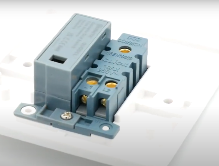

I'm just wondering if anyone knows whether any/all of the Quinetic grid switch modules fit in a 25mm back box?
It "looks" just about ok. But if it definitely doesn't it would be nice to know!

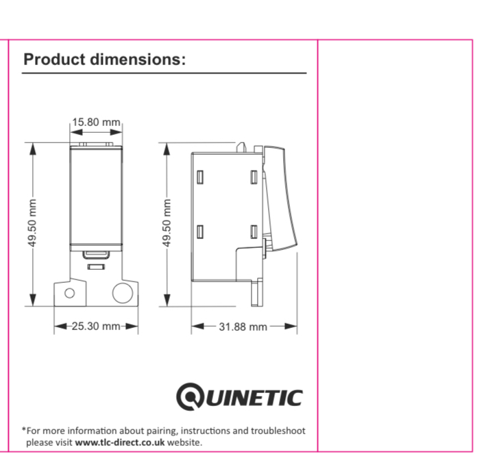

I've not done it, which doesn't help!
If Quinetic's drawing is to scale, the depth from the mounting face of the module to the rear is definately under 25mm.
