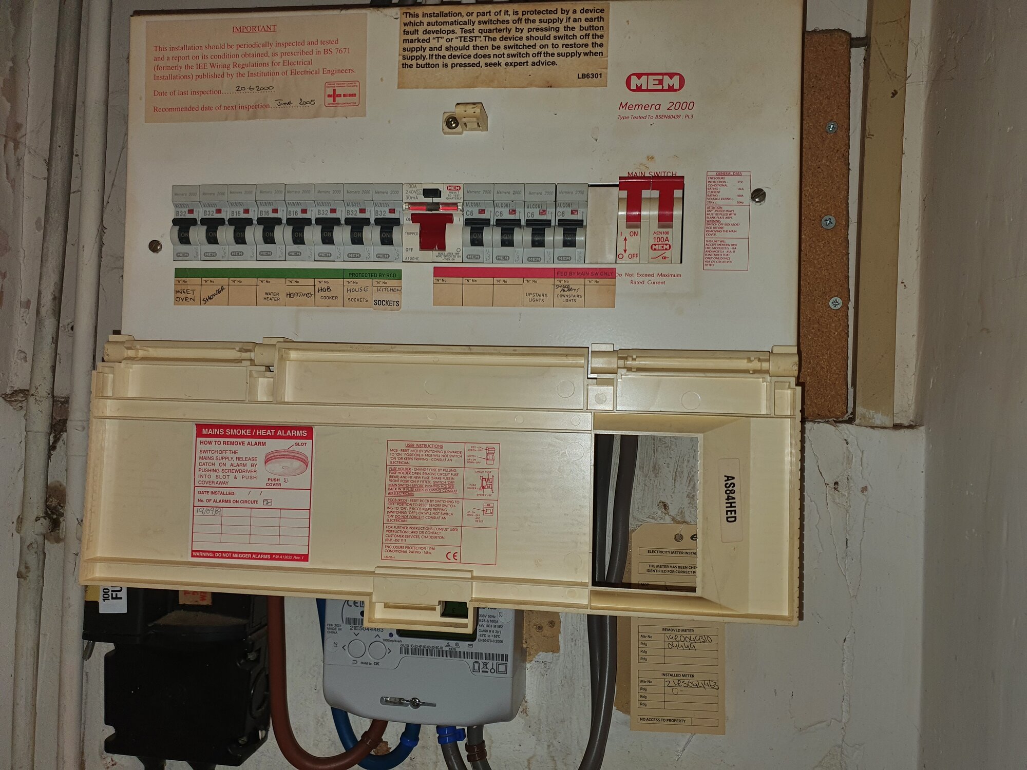

Hi
I am.from uk
I had a gas top up meter and a electric smart meter installation
Thought to ask my energy supplier to fit me a gas smart meter aswell
Their enginner came and said we will have to install the electric meter aswell so they will combine the smart thing on the display
But after installing the new smart meters
My rcd been tripping time to time even with all switch down on the main board
It did trip 2 times while he was here - but then worked absolutly fine he did open the unit and check and tighten all connectio
In last 5 hourd have tripped 2 times
Can anybody advise?
Strange because i already had an electric smart meter installation and never had this issue so why now?
Thanks
Can anybody advise me?
I just moved in this house in march as we bought it, thats the reason we wanted to switch for a smart meter for the gas instead of the already prepaid meter installed

I have come across this exact problem. All the tests came back fine, there was no indication of a fault on any of the circuits
Same brand RCD, old memera one. Have read online of others having the same problem, again same memera RCD. Basically the smart meter is interfering with the RCD, causing it to trip randomly.
In my client's case, the smart meter was immediately below the fuse board. (don't laugh!) I took a piece of cardboard, wrapped tinfoil around it, and placed it between the meter and fuseboard. It hasn't tripped since, I kid you not! Obviously, if you intend to do this, make absolutely sure that there are no exposed live parts that could make contact with the foil, or you'll be fried alive.
Call your supplier and mention that its happened since the visit from the Engineer. He may have left a loose connection or reverse polarity (both of which can be dangerous). They may send someone out to check on the meter. Or if the problem persists, may pay for a sparky to check the properties circuits.

Hi everyone
I called an electrician twice , he charged me crazy money ?? however because of the tripping or during the installation he told me my electric shower has became a hazard, need to change it as it showing some fault in his reader...
He became crazy as he couldnt find any fault, and then asked me what time the tripping happen, and other questions, he came to the exact conclusion of pretty mouth that the unit memera one in the past for one of his client use to trip just after the installation of a smart meter
As pretty mouth said its exactly whats happening for me, as i mentionnet in my first post, eon came to replace the gas meter ( as i already had a smart electric and never had any issue) but decided he will need to put a new electric meter and synch both of them, the problem now is everytime.eon send a signal to the electric meter as it uses radio signal, which i guess are so strong it trip my rcd memera one
I haven read about your tricj regardent the foil but i am afraid of that as i have 2 kids at home
Can anybody advise me please? I already paid more than 200£ for the search of the problem.and now i have an electric shower to replace ????
I am going nuts and really dont know what to do
Could i call eon to come back and replace the meter ?? Or any other thing?
Thanks again for all readers and replies

Does the shower still work? Sounds like he's damaged the electric shower whilst carrying out insulation resistance tests? But would only really happen if it was one with electronics in.... who knows...

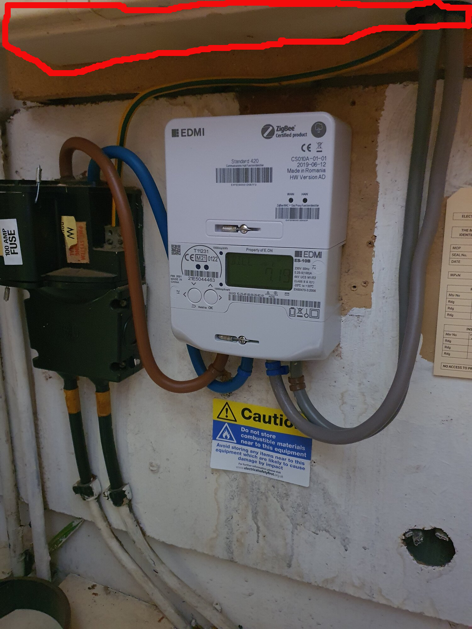

Just try the tinfoil wrapped cardboard trick first, the tinfoil isn't connecting to any electrics so no risk to yourself and kids.

Can you or somebody advise in the picture where should i put it? Thanks
