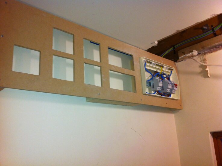

Hi Guys I've been posed a bit of a tricky question with regards to installing a consumer unit into a stud wall the client has asked for it to be recessed back so that only the removable lid is protruding from the wall. But doesn't want to got to spend out on a recessed CU which best price I can get from the wholesaler is about ÂŁ190 exc VAT before the breakers are considered.
The question asked was am I able to install a Plastic CU into the wall and mount it onto a board between the uprights of the Studs. A board could be fixed in between the studs and a that section left open and free from insulation to allow air flow.
I'm at a bit of a loss to the answer my initial reaction was that its a possibility, but then thought it might be a good idea to use a metal clad board if this was going to be the case.
Any help and suggestions would be appreciated.
Thanks
your way would work but you would need to leave a biy proud fot the lid to match upto.also there may be an issue with rire rating if the wall is a route for fire to travel ect
Leaving a bit proud wouldn't be a problem in that case. I dont think that its going to cause any issue with it being a route for fire travel, any more than the rest of the timber frame at any rate.
But am i right in thinking that a plastic backed CU would be a no no then?

needs to be a purpose designed recessed Consumer unit or forget about it, its all about the fire safety.....it needs to be the ÂŁ190 unit and he will have to buy that one, if he wants it fancy thats his problem, its all about using as intended by design....
Did it for a 84 year old lady with arthritis her consumer unit was very very old with plug in MCB,s and in a cupboard at high level she stood on a stool to reach it which was mounted on stud wall so i flipped it round lowered it and sank it up to the LID on the CDU sealed all the holes with intumisant sealer she was well happy now she can reach it ,threw in an emergncy light in her hall for free so she could get to the consumer unit when an MCB or RCD tripped

You could construct an enclosure recessed into the wall with an air gap around the CU. Timber frame and fireboard back, sides, to and bottom, intumescent sealant where the cables enter the enclosure but no need to do it at point of entry into the CU. This would allow you to sink it completely so that the face of the lid is flush, (customer's requirements) preserve the wall's fire protection, yet maintain a suitable air gap and accessibility for the CU (Regs and BC satisfied).
