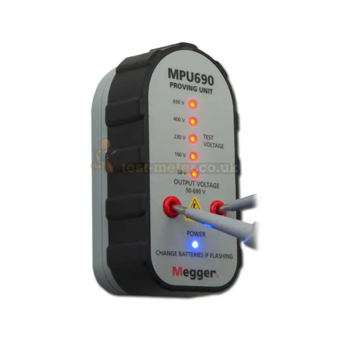

It is a matter of preference, but I prefer the ones that are only a voltage tester and don't squeal lightly differently on continuity.
The number of times I have been checking N-E and jumped thinking "it still live!" only to realise it is the squeal and LED for continuity, not the other squeal and row of LEDs for voltage. Added advantage is no battery to look after (or ignore and find it has corroded the unit making the proving using even more essential).
So if you can afford it the Drummond as @Pete999 says, or going cheaper maybe the TIS819 or Di-Log DL6770 ?
Not sure if the OP is more interested in the proving unit?
I got this one and it has been fine, so far needs new battery set after about 9 months though (probably typical for such units, but not enough experience here to judge others):
The unit's LEDs go to 400V but it has a final step to 690V. Switches on when you push the probes in to the test sockets, but you can manually start it if checking a non-contact tester.
If you have a non-contact tester then remember it only should be used for guessing where live wires run, never for proving dead.

I must say my go to is my fluke 1000 meter is my go to , it lives in my tool box.
my proving dead unit and Martindale tester rarely see the light of day
I have a Megger one, MPU690 and it seems a decent piece of kit, and has magnetic base.
As previously stated, you need to shop around and get a deal as the prices seem to vary quite a bit.
Good point. I have been using multimeters from long time but once here in UK I started to see those type of equipment. Very different.
Multimeters are frowned upon for this job for various reasons. One is they have a very high impedance (typically 10Mohm) so tend to read "phantom voltage" from capacitive coupling to other energised circuits, whereas the light/LED style take several milliamp so don't show this (in most cases).
But more fundamentally it is the number of ways you can go wrong (using DC volts, or amps/ohms and blowing the meter fuse, having an arc-flash if unfused amps, etc) with possibly fatal results! Hence the idea that a voltage tester should be simple and unambiguous.
