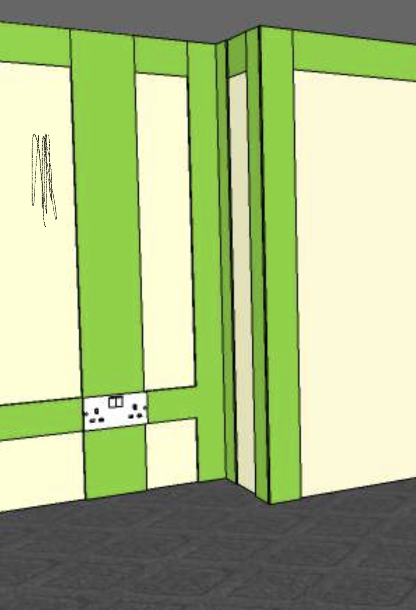

Hi,
I’m hoping someone can signpost me to any regulations that exist for installation of mains wiring cable in a domestic setting. An electrician has installed a mains cable within 30mm of wall surface in almost the centre of a wall and I’m wondering if there are regulations against this installation as i’m concerned that about the safety of this work.
Many thanks
Marty
Photo's would be good

I'm wondering if you possibly have an outside cabinet with main fuse, meter, and switched fuse, and that cable runs from the switched fuse to an indoor consumer unit. Wild guess....but only way it's adding up in my mind right now given the cable type and that an electrician fitted it, not the suppler.
If that cable is your side of the meter it would be allowed to be installed like that as it is mechanically protected.
Understanding exactly where that cable is relative to your main main fuse, meter, and consumer unit is key to saying who is responsible for it.
(the cable on the right is more complicated, we can come to that later!)
Trying to work out if that is a cable or something else but it is damaged. I asked earlier but no confirmation.
