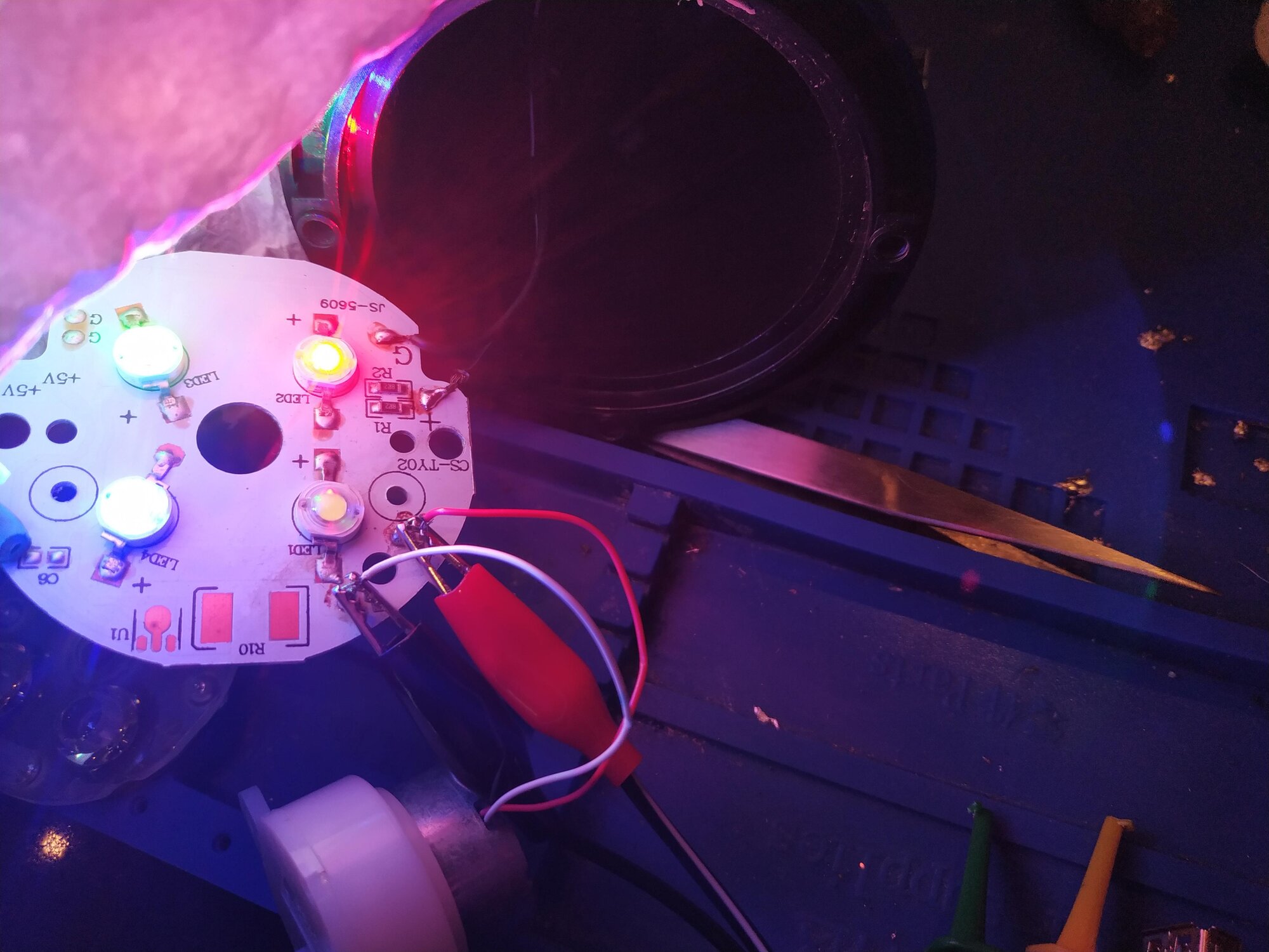

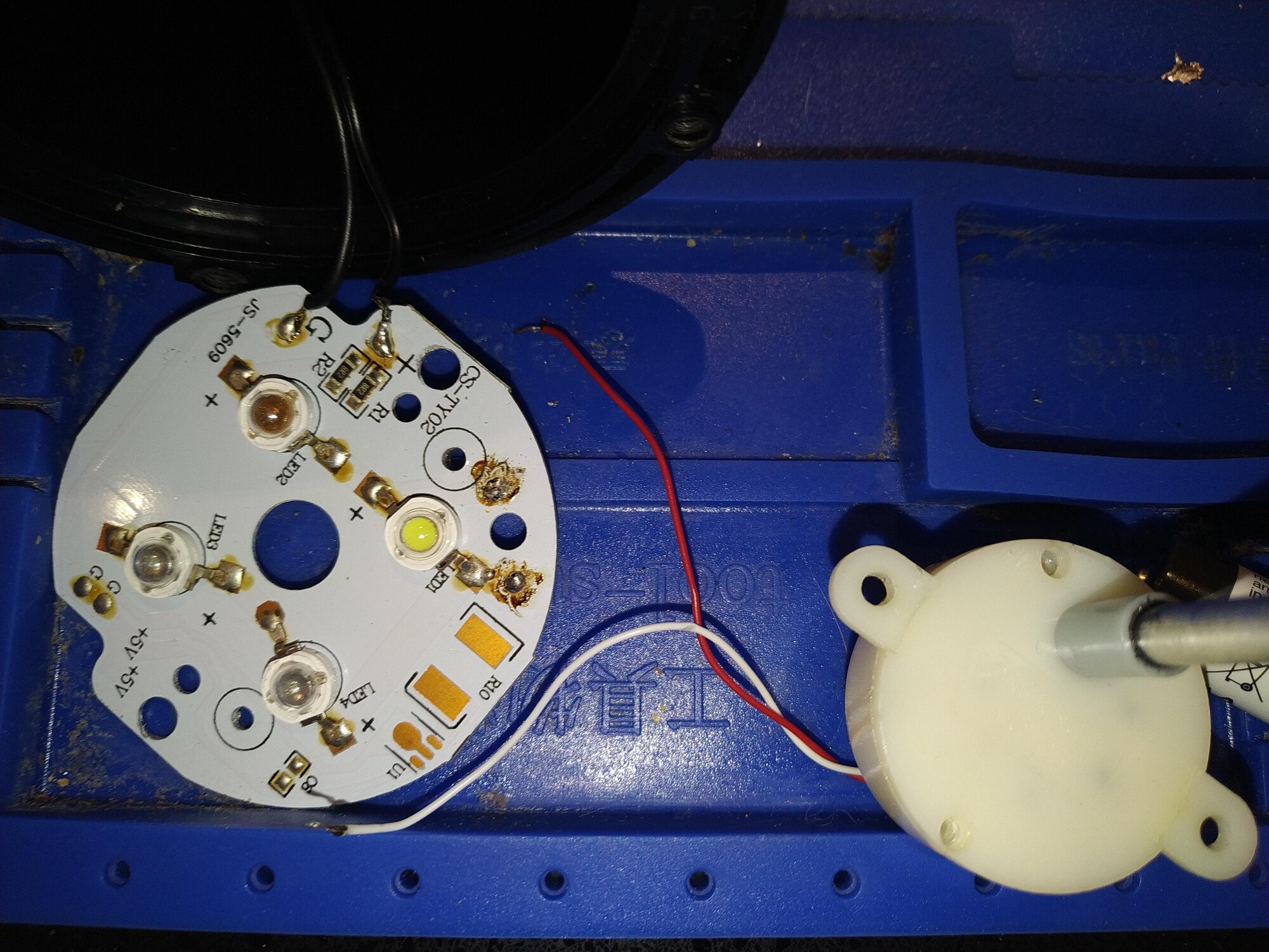

I disassembled a Christmas light projector to try and identify the cause of why the images from the projector weren't moving at all, when they used to. Looks like a couple of wires have come loose between the board and the motor wires.
I'm not sure which points they need to be soldered back on to. If I try the two empty contacts on the board, there isn't any movement in the motor. Other combinations cause one more more of the LEDs to lose power, so not sure what to do/what I am missing.

Which ones have you tried?
I would expect these two…..
[ElectriciansForums.net] Repairing Christmas light projector
As they seem to be the only other ones that look “used” but that might be from where you have tried already.
Do you have a multimeter that you can use to measure voltage?
Thanks for your reply, I do have a multimeter. What do I need to do?
The contacts you have circled are the ones I tried. I think the red wire may have been connected to the bottom contact as the end of that wire was missing and there was a bit within the solder. The problem was when I tried connecting the white wire to the other one, it stopped some of the LEDs working.
Did you try it the other way around, or was there red remains in the solder?
Use the two prongs of the multimeter to measure between the two connections on the board. When the motor is supposed to run, there will be a voltage value present, and zero when not.
Set the multimeter one stage higher than the supply voltage of the device, and have it on DC Volts.

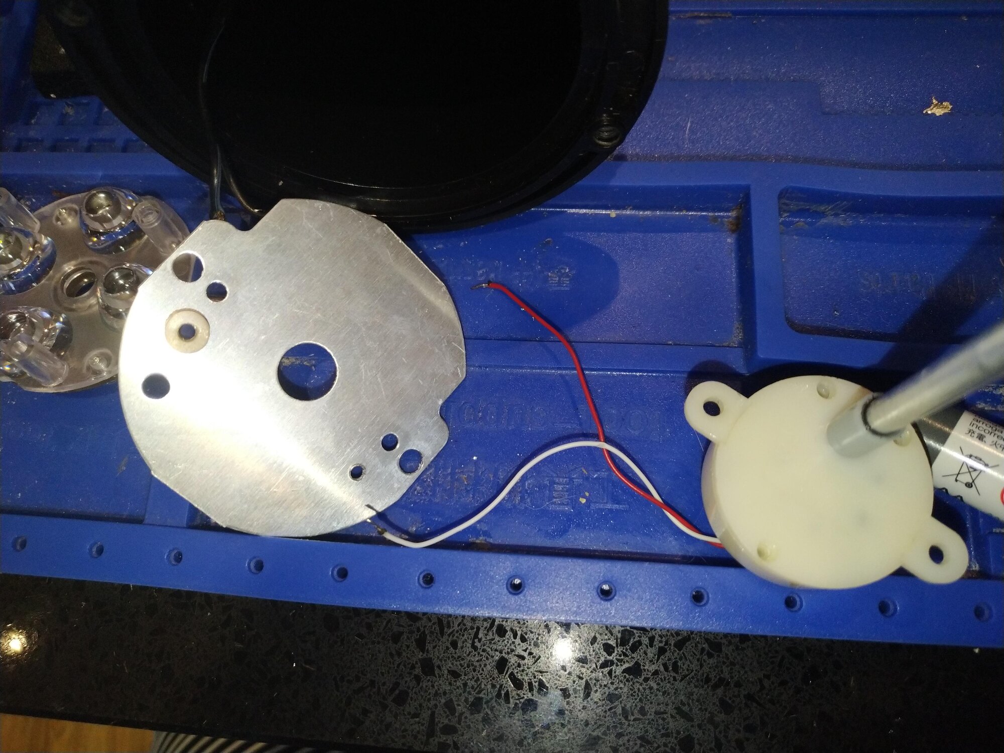

Thanks for your reply. I removed the motor from the gear housing and it spins freely when I turn it, but when I use a 3v cell button battery it does nothing.
It looks like the motor from a CD/DVD but in my experience those don't usually have cables coming out of them, they connect using contacts on the base that aren't available on this one.
How would I track down the right one? Does it have a specific name? Do they come as standard with 7 holes in the top?

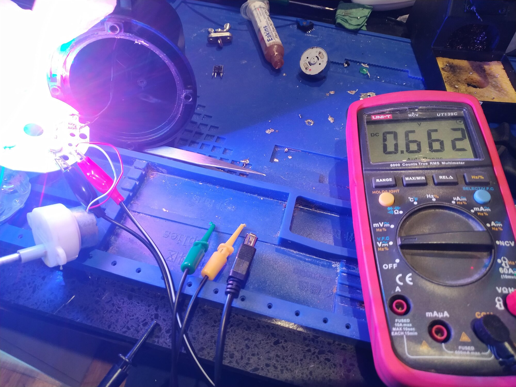

Since the motor, when connected to the pcb, causes the led to dim, and the voltage on the terminals it connects to drops from 3.2V to 0.6V, the motor seems to have a low resistance (but not work!)
Another test could be to put the multimeter on a low dc volts range, spin the motor and see if any voltage is generated by it!
If it doesn't run on a battery looks like it'd died. Have you tried spinning it while on the battery?

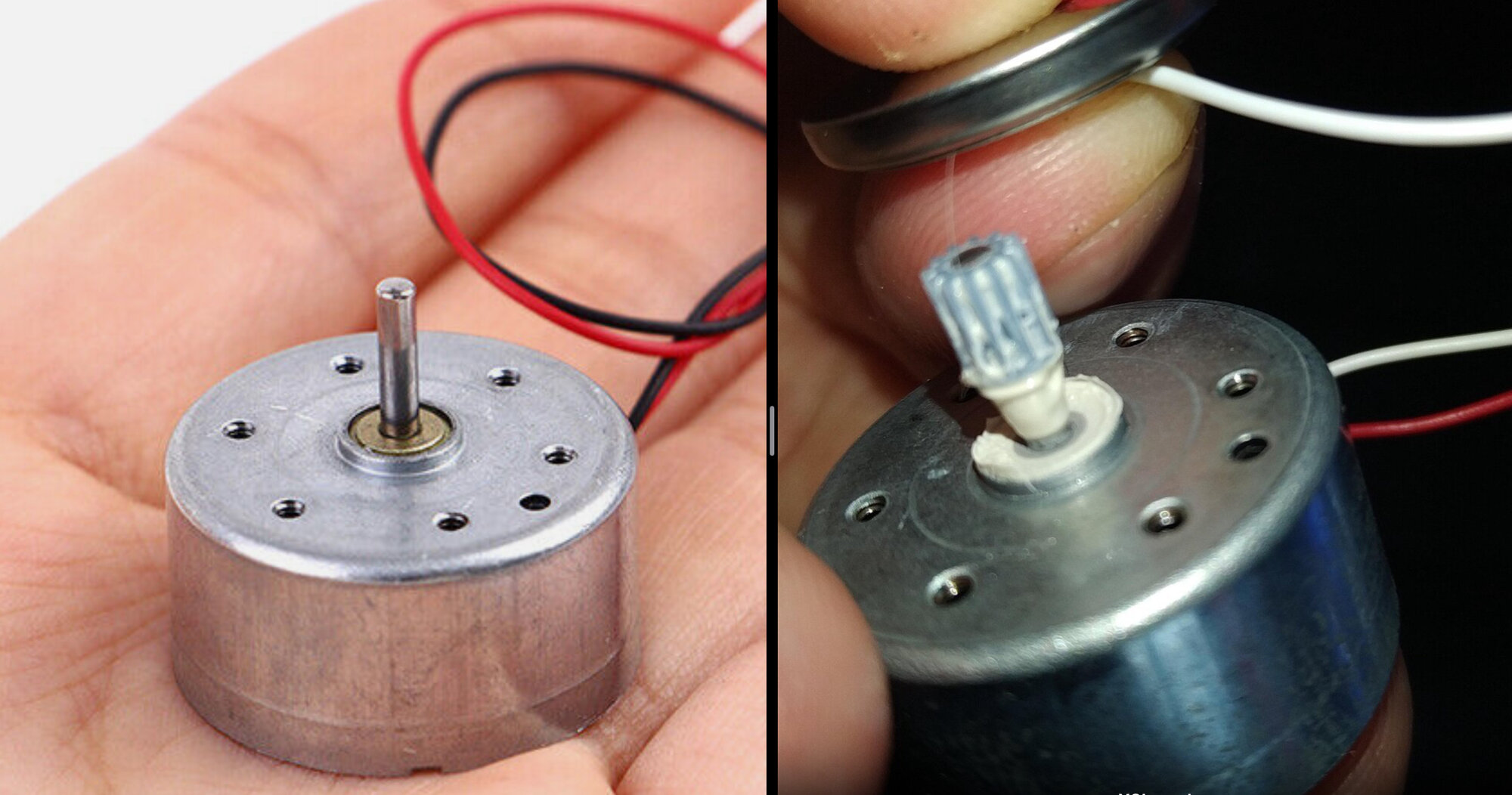

There must be zillions of motors out there, finding a replacement could be a challenge.
If you are able to take the pinion off the motor shaft to put on the new motor, you will need the same shaft diameter and length on the new motor, and preferably at least one fixing hole to line up!
DC 1.5V 3V 5V 6V 6600RPM Micro RF-300C Motor Small Round?​
That 300C reference looks useful.
Prompted by your post I had a quick look and they do look similar, eg:
If you have a pair of vernier callipers you could check the measurements of yours against the drawing dimensions in the link above.
They do look alike!
