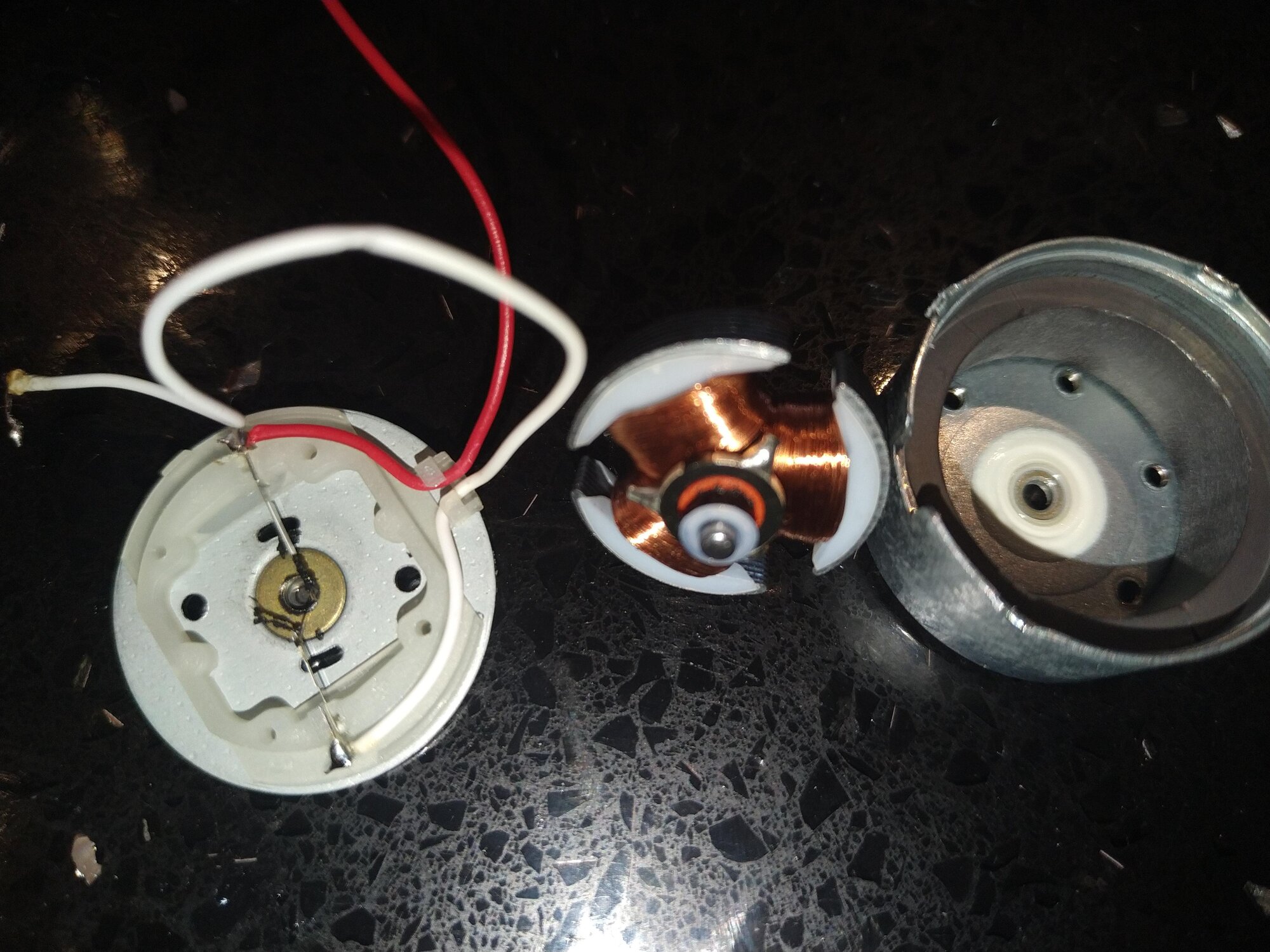

I disassembled a Christmas light projector to try and identify the cause of why the images from the projector weren't moving at all, when they used to. Looks like a couple of wires have come loose between the board and the motor wires.
I'm not sure which points they need to be soldered back on to. If I try the two empty contacts on the board, there isn't any movement in the motor. Other combinations cause one more more of the LEDs to lose power, so not sure what to do/what I am missing.
Could someone please help?

If the motor is jammed it will likely take more current which could cause the voltage across it to fall.
If it won't run on a 3V battery it's probably at fault. If you can get into the whole assembly you might stand a chance of finding what's wrong. It could be the reduction gears or the optical element they turn is stuck, or the motor itself, but in my limited experience the motor bit tends to be more reliable than the plastic/nylon gear trains they drive!
PS: Are you running the whole light projector off its original power supply?
I've got a couple of things to fix where the motor seems to be the problem.
I don't understand what could be broken in this assembly? Does the circular magnet wear down over time and need replacement? If so, where can I get one?

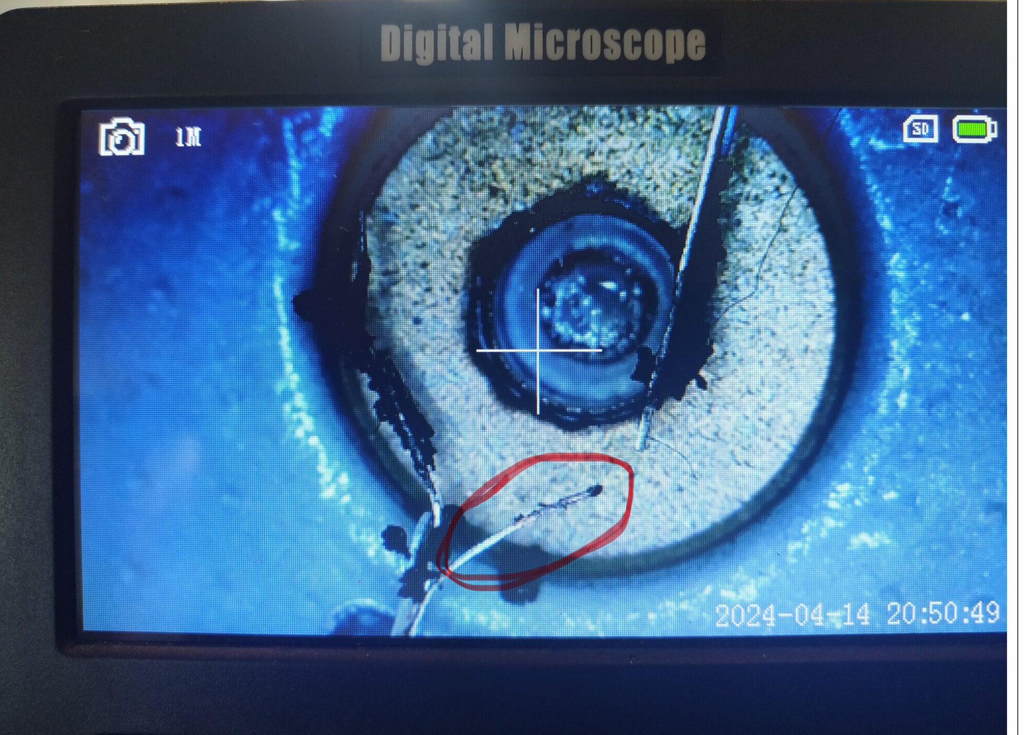

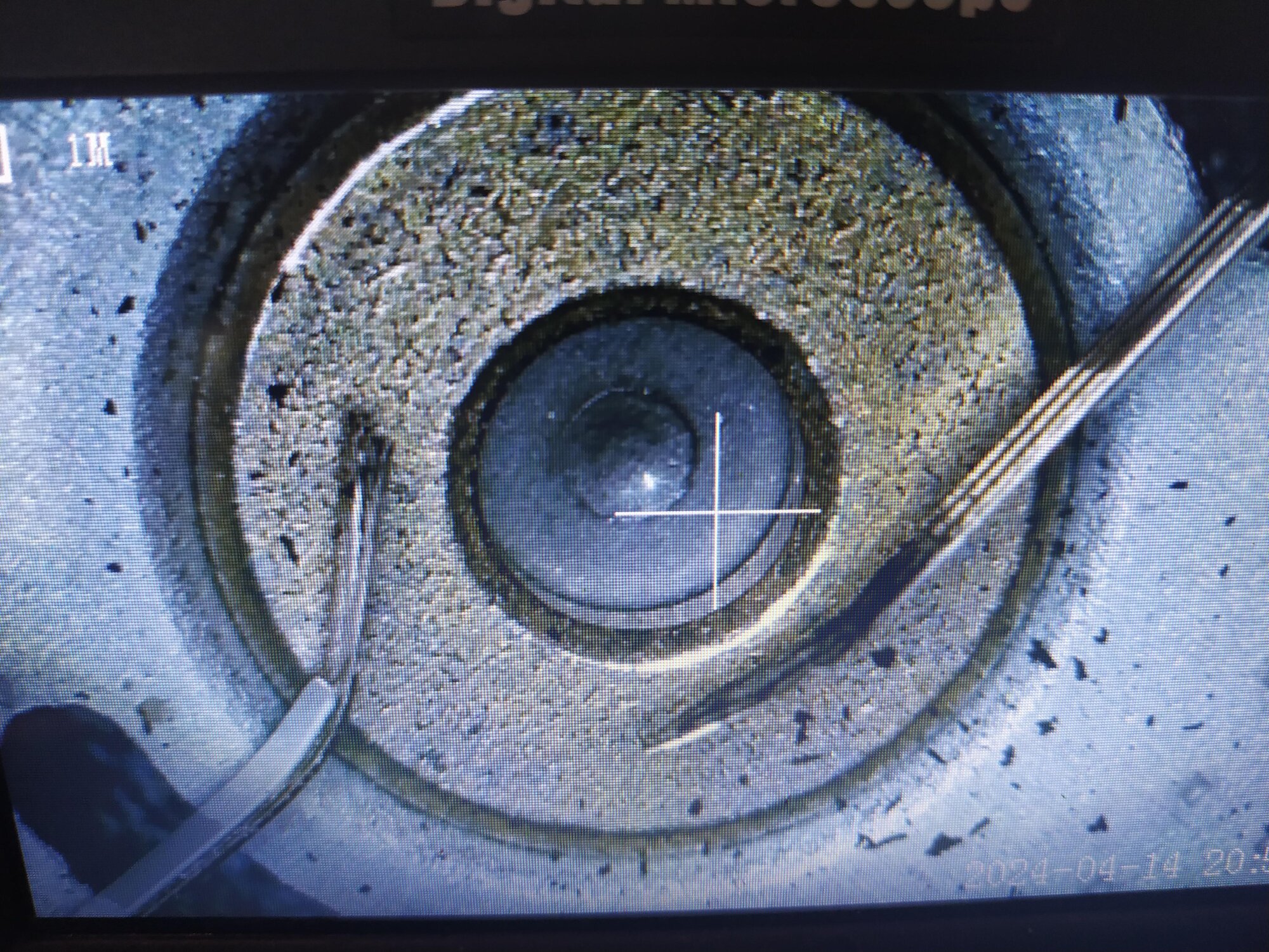

The common failures are a break in the armature coil, or the 'brush' mechanism worn or not making contact. It looks like one of the contacts is bent up (ringed), shouldn't that contact spring be straight? Or has a bit broken off!
Those two contacts should press lightly (but not too lightly!) on each side of the commutator to provide current to the coils.
Use the ohmmeter to set it up.
Well that's the problem.
One spring 'brush' contact on the Christmas light motor seems to have got bent, with one of the leaves pulled away in the wrong direction from the others (outlined red below). If that bent back piece was touching the same commutator segment as the other brush, it would explain why the motor didn't run, but had resistance.
Maybe the black is the remains of what were small carbon brush contacts, or it's some sort of grease?
I don't think there is much point in trying to restore it or fabricate a replacement given the motors are so cheap.
If there's enough of the springs left, you might get the motor to run by cleaning them up and bending them together, but I don't think it will last for more than a few minutes, or perhaps hours if you're lucky!
