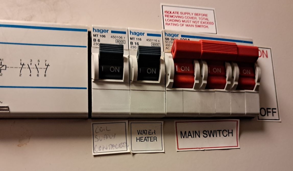

Had a new unvented Boiler fitted as the old one had reached the end of it's life. Electrician mentioned that it might be worth replacing my fuse box and giving it a separate RCD. My fuse box appears to have 10 black switches and the 3 red main ones, was last checked by an electrician in 2020. Cost is about £600-700. Just not sure about the pro's and con's and obviously after buying a new boiler if I should do it sooner rather than later as the cost is a fair amount for me.
Anything that would help me make the decision would be gratefully received.
Stick a picture of the consumer unit on here for better advice.
I’m not a fan of changing them unless there’s a good reason and clear benefits.

I have to agree, I'd also be suggesting there are benefits to upgrading that one.
RCD technology is a good thing and it's getting rarer to find no hint of it at all.
That looks like a metal enclosure? Hager RCBOs are about £15 a pop, so about £150 for parts. Can anyone see why it shouldn't be upgraded rather than replaced?
As a cheaper option I'd agree you would at least get type A RCD protection with minimal disruption.
For about £150 more in parts you could have surge protection and RCBO's that switch the Neutrals too (Hager's don't) giving better isolation of future faults.
