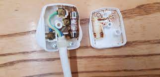

I read once, never seen one for sale, that there is a solid brass replacement for the standard 13A fuse in a 13A plug. This is to eliminate the fusing in the plug, which is handy when having a heavy appliance plugged in behind itself, like under worktops which are isolated and fused by an FCU.
Anyone know where they are available, if they are?
On a dedicated radial with its own MCB and say a 20A isolator switch a washing machine can have a 15A fuseless round pin socket and plug. That is fine, but many manufacturers say that if you remove the 13A moulded plug the guarantee is void. This would never hold up court if an appliance is connected to regulation being sound and safe, but it is avoiding the hassle factor from these irresponsible makers.

A solid link converts a 13A plug into a fuseless plug - not difficult to grasp. Guess what? Fuseless plugs are legal. ;)

I have been in my trade pushing forty years and I have never come across a manufactured solid link for a 13A plug. This obviously does not mean they have never existed but I doubt they have done, why would a manufacturer produce such a thing, how would they certify it as a compatible component for a 13A plug so that it doesn't affect the safety of the original product. A few years back products were being imported, in particular cctv equipment which came with a fitted moulded plug but no fuse, these were flagged up by Trading Standards as non compliant and dangerous.

Several of us will have come across solid links but they were not off the shelf products they would have been home made. There is nothing to say you cannot fit an alternative plug which does not incorporate a fuse however the appliance instructions are likely to suggest, in the UK it should be a 13A plug.
I have come across 13A solid links, and knew guys who used them. Not seen one for years, hence this thread. They may not be available any longer as the demand is not there. Nothing in any reg say they are illegal. Solid links are available for many applications.
