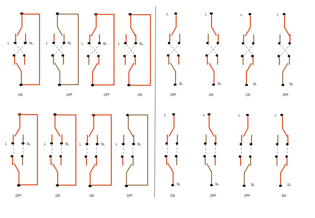

I would like to ask also for testing of 2-way and intermediate switching.
In scenario we have got:
2-way, intermediate, intermediate, 2-way.
Let`s start from R1+R2 value.
Test probes on last light fitting point in circuit on L and cpc.
Taking a reading, then
switching first swich to opposit position, reading
then second switch to opposit position,reading
then third swich to opposit position, reading
then fourth switch to opposit position, reading
So those tests verify polarity also.

Slightly more complex to answer this one as there is a practical approach and an approved testing approach!
In testing R1+R2 any reading on a light circuit, where the light would be on if the circuit were energised, should be substantially the same and all readings where the light would be off should be open circuit. However to test for switching in the line conductor each switch should be operated to verify this.
Therefore your sequence of testing for R1+R2 would be correct except that the last action you show would duplicate the first, so is not necessary. The readings would be taken to verify disconnection of the line when a switch is off.
Practically if there are two people; testing when switch one is in one orientation and then the other, then the same for switch two, and three, and four might be easier.
For IR testing the light switch is only switching the line and so the status of the Neutral and Earth do not change so there is only a necessity to test the Neutral to Earth insulation resistance once.
The testing of insulation resistance needs to test the line against the neutral and the earth, but the switched line will vary depending on how the switches are positioned (for two wire/conduit wiring).
Your sequence would correctly test all the line conductors.
This diagram of two wire wiring shows the options you have given and the IR test from L to N and L to E would be testing the red coloured conductors (those that would be live when energised).
[ElectriciansForums.net] Ring final circuit conductors and value Zs and R1+R2
On a practical basis, not when doing exams, note that you would have covered all conductors after the first change.
Also if you are doing initial verification and know which switch is which, then for three wire / conversion wiring when the light would be on all line conductors would be tested so you can test L to N and L to E and then reverse one switch and test L to N and L to E again and be sure of covering the options.
For two wire / conversion wiring testing L to E and L to N and then reversing the position of the first and last switches (the two way switches) and testing L to E and L to N would cover all the line conductors.

Regarding IR test, just to be sure:
-option three wires, as second part of this test, only one switch needs to be operated
-option two wires, as second part of this test, both two way switches needs to be operated
The on site guide only gives the advice that on insulation resistance testing that the switches must be operated one at a time and further measurements taken (not very specific!). Your training provider should advise you on their approved method for you to use in training.
When actually doing testing use the most convenient method available at the time that will allow you to be sure of your results.
R1+R2 should be, for initial verification, measured at each point in the circuit, and so when measuring at switches the switches can be operated on and off at the time to check the line is being switched.
As a short answer on the IR testing, YES.
As a long answer:
The attached diagram which is an old one shows diagrammatically the cables that are live on a three way switched circuit for both two and three wire wiring.
You will be measuring IR from the origin of the circuit so this effectively applies the test voltage to the incoming permanent line for the switches, therefore you will test all the red coloured conductors in any one diagram when you test, any that are brown will be omitted from the test and the switches have to be set so that these brown ones then become red.
If you look at three wire wiring you will see that all conductors are connected to incoming live when the light would be on so in that case an IR test (L-N and L-E) will cover all line conductors in the switching arrangement.
For two wire wiring when the switch is on you will cover half the strappers between switches, changing the switch that is supplied by the permanent line will exclude the switched line but switch over to the other strappers, then changing the switch that is connected to the switched line will include the switched line as well as the other strappers.
