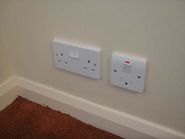

I like this one.
  • [ElectriciansForums.net] Running Conduit into outside sockets.
