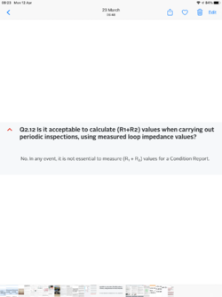

Where is that answer from out of interest? I'd read it as saying that R1+R2 may not be needed if Zs has been taken for each circuit - as that checks polarity and is possible even when circuits cannot be isolated. It is also the defining limit on whether the OPCD is satisfactory.
It's correct that you can calculate Zs, but not the reverse.
Mind you, even the cheapest plug in socket tester should have picked up reverse polarity (assuming L-N switch).

It’s from the Niceic site.
