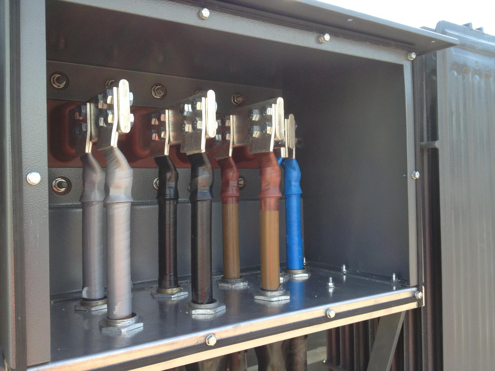

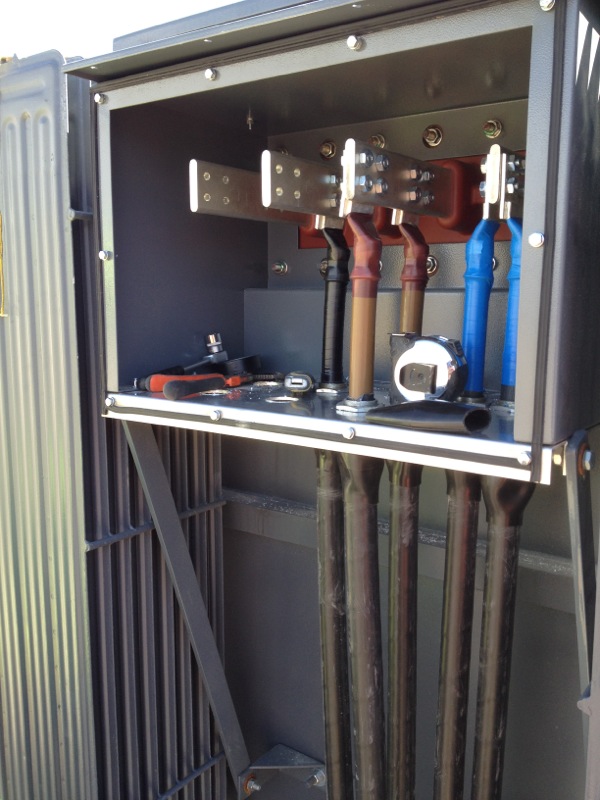

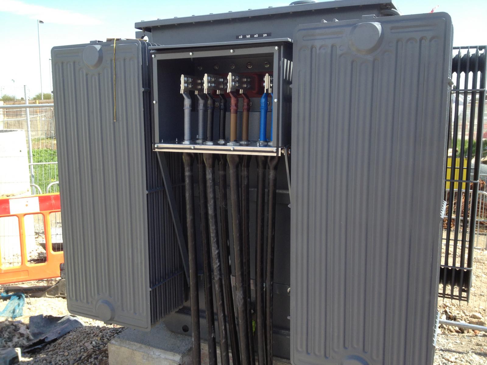

Presented with no comment.
[ElectriciansForums.net] Sexual - Still makes me tingle[ElectriciansForums.net] Sexual - Still makes me tingle
Pity you didn’t put the lugs on the opposite way around. They align better between the gland plate and terminal.
We usually used 600mm 4 sector solidal. Brass glands and locknuts though a slotted steel gland plate, the slots filled with epoxy.
Jesus wept, AWA glands come with Ali lock nuts and Ali banjo's.... RoB2 obviously hasn't used them before....
Why in the name of god would you use banjos on a metal gland plate?
What purpose would they serve?
The transformer glands are quite adequately earth via the aluminium plate so no need for banjos, the switchgear end is in to an insulated gland plate. Having an earth at both ends would cause circulating currents.
I await your answer with interest.
Read the thread, I already have, it's only what you and the other guy are concluding and suggesting that's what I'm thinking.
the glands would have come with them and I'd have fitted them, personal preference or just habit I suppose.
But to what end? What would be the advantage of fitting them?
It's like glanding an SWA onto galvanised trunking, you wouldn't fit a banjo then would you?
Doing something because it is just habit suggests a lack of thought or understanding of the job in hand.
