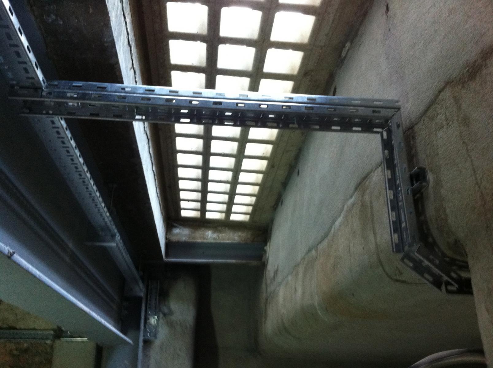

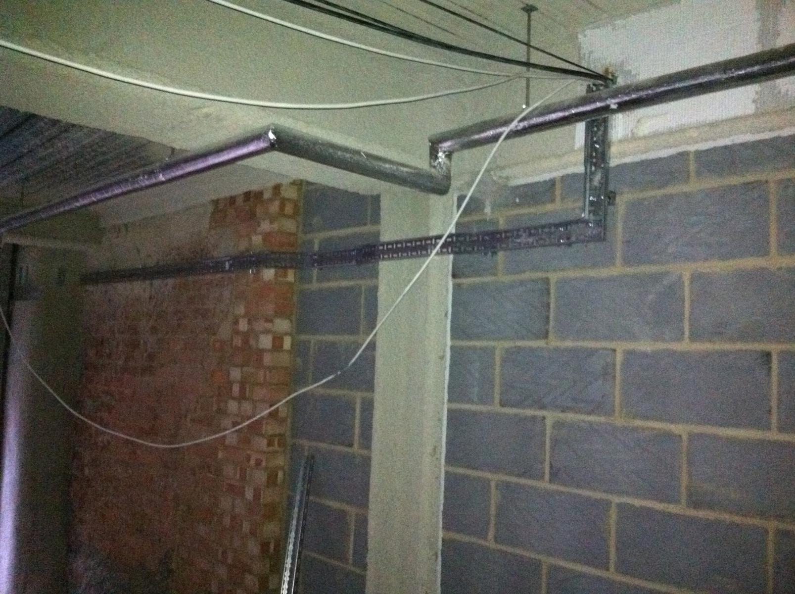

Well, here you go. Both of these bits of tray are one piece excluding the flange in No.2:

And another bit of tray, hand bent lol:
Now that's what I call some serious artistry.
Hey Banjo, your tray isn't to bad:20:
Do you want some advice? Gonna give it to you anyway lol.
Firstly, try and flange all of your joints. E.g. If you have two pieces of tray that are meeting at right angles, like a 'T' for instance, flange both sides. It's easier on the cables that way, and a well gusseted joint looks 100% more professional IMO.
Secondly, I think you need to be making the radius of your bends much bigger than they are. Same again, easier on the cable and the eye. One cut bends don't really cut it in my book. Remember, this isn't trunking and you want to remove as little metalwork as possible to keep the trays inherent strength.
You look like you have the makings of a good tray guy.
Keep it up.
Hi mate,
when making my own bend, i always put a gusset in, this particular job we were a bit strapped for time and my boss was breathing down our neck lol. I love bit of metal work i'm only 20 years old but can smash most the spraks on my firm at metalwork :). I like a lot of your work look very impressive mate top notch!!

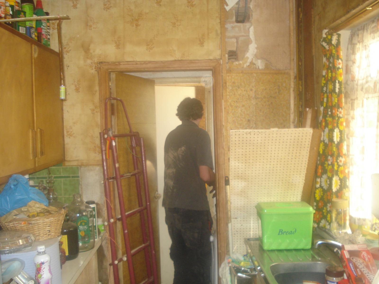

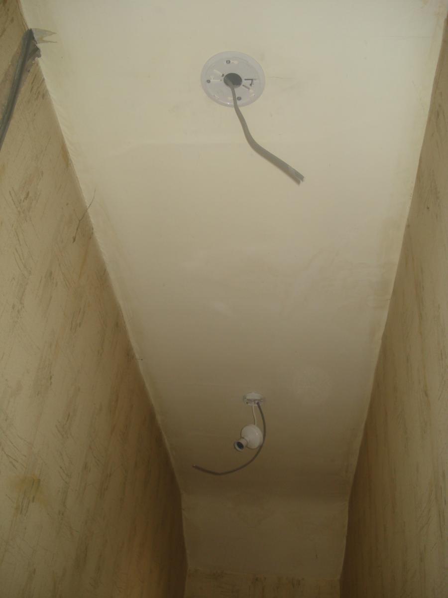

Ok
The first 5 pictures are a rewire we did, how nice was the person moving all of his crap out of the way.

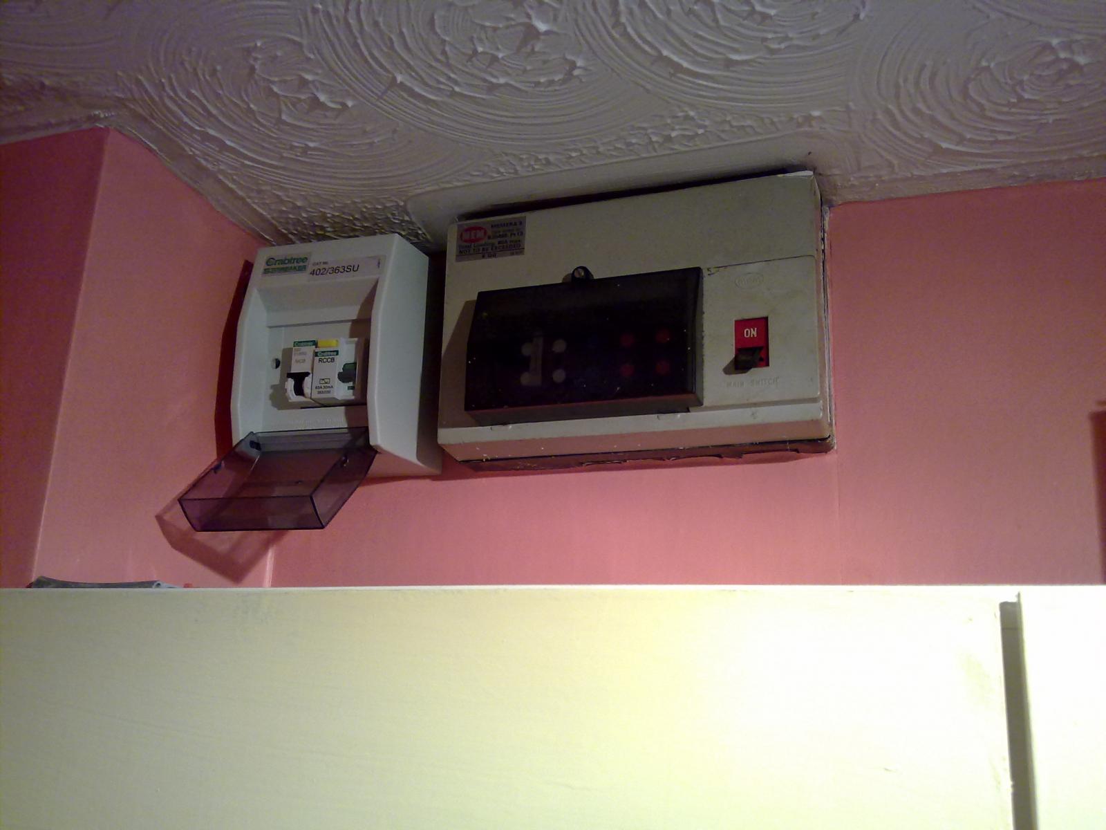

Next 3 are a new board to protect some sockets and lighting, did tell them to have the whole thing changed but nah.

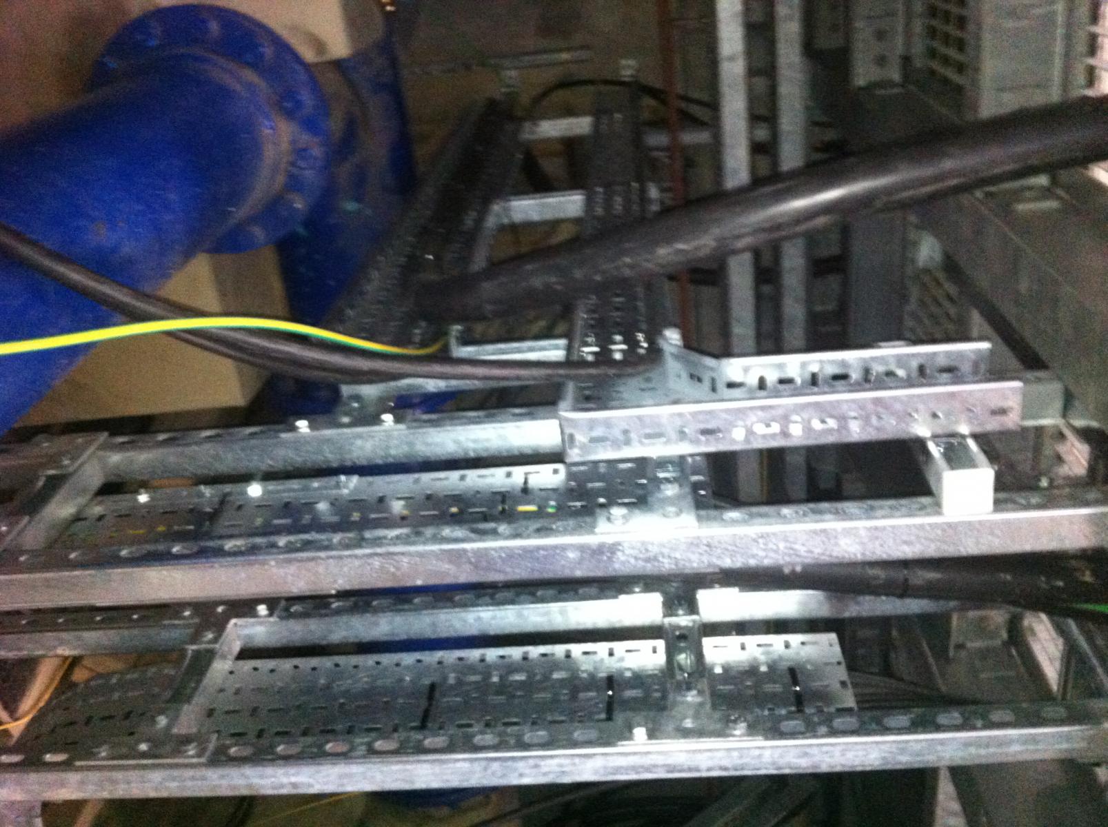

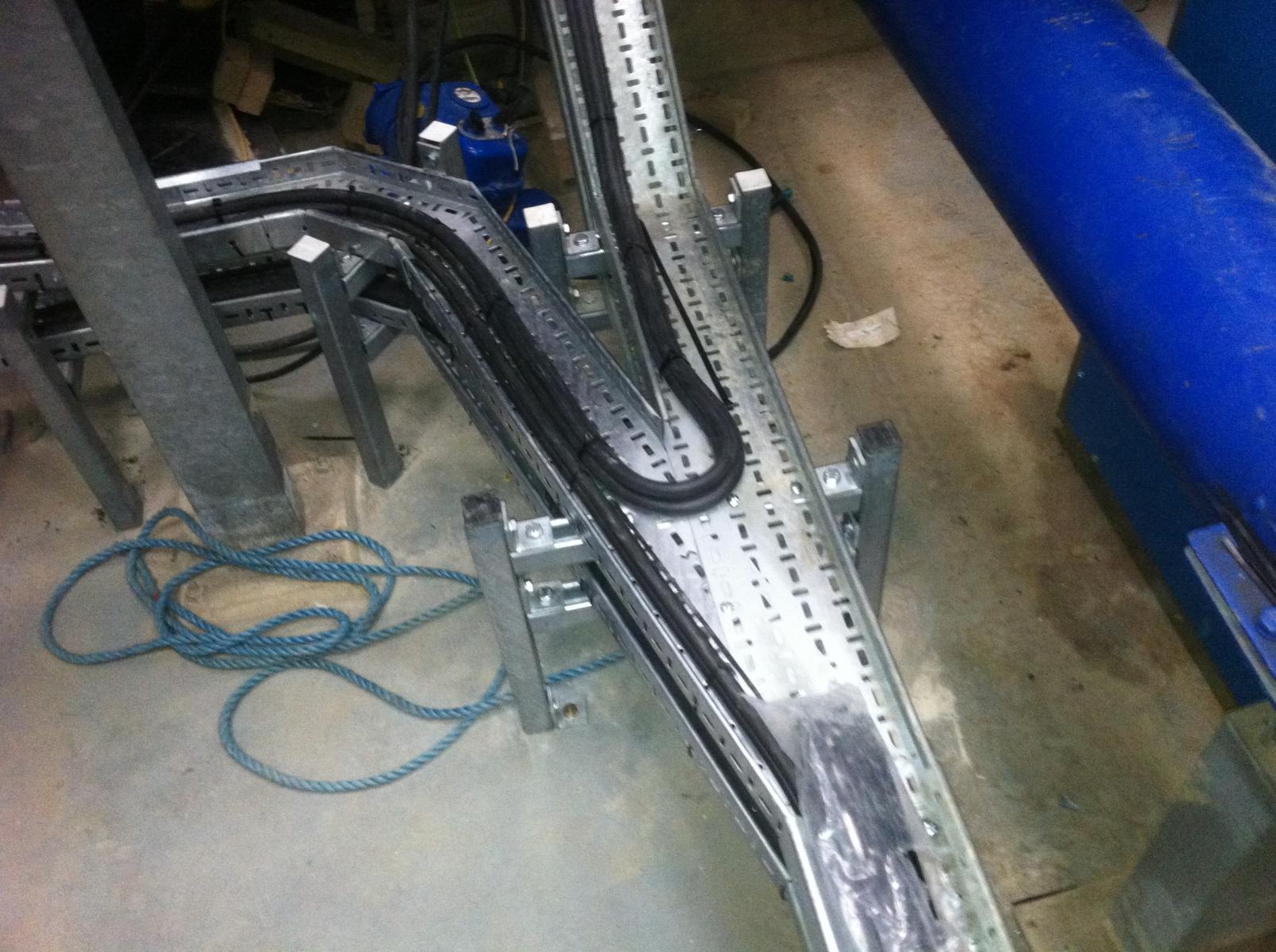

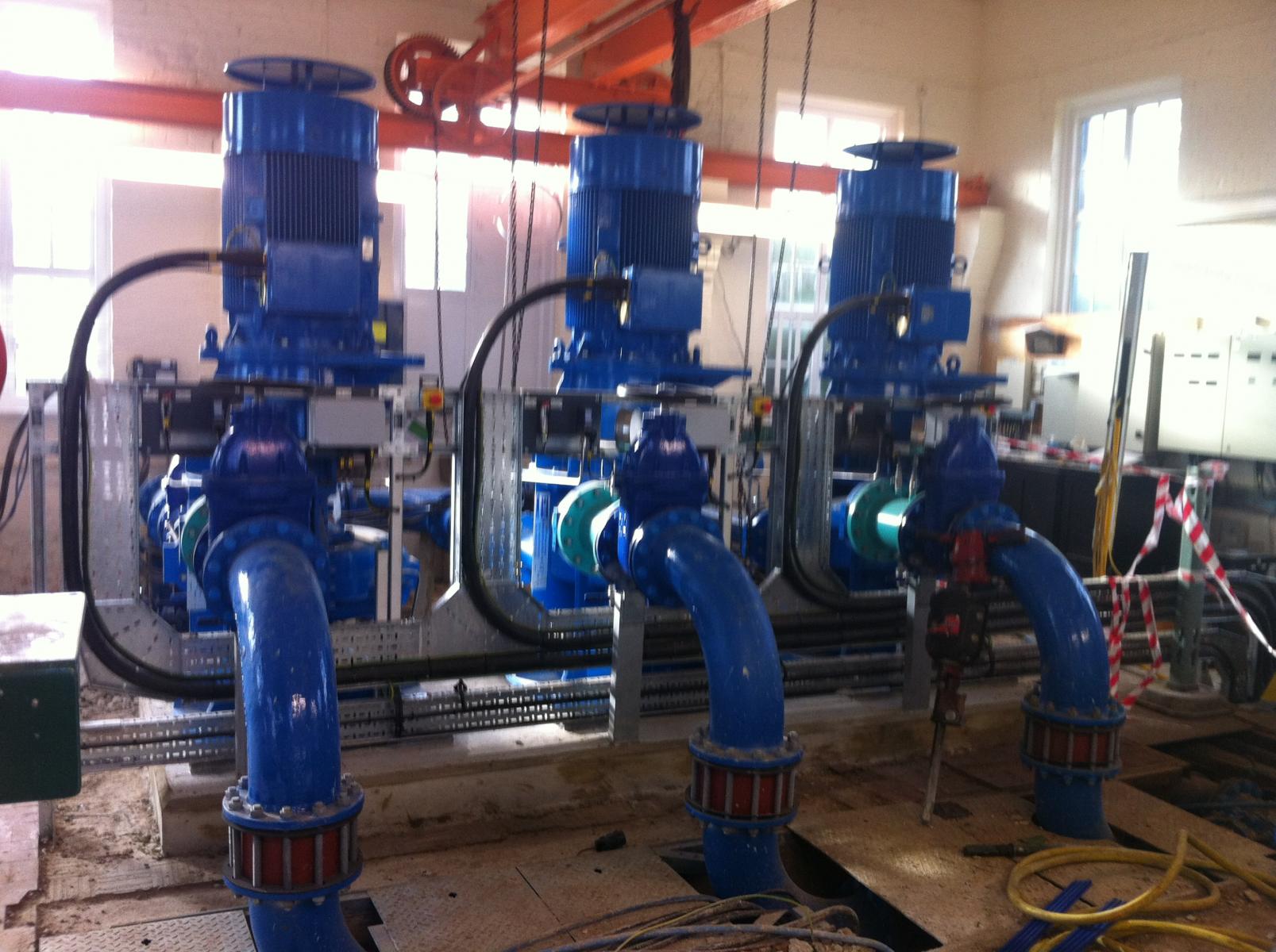

This job was done using pre-manufactured bends. They are not to bad on heavier duty tray, but rubbish on light or medium duty. This was heavy duty tray. The pumps are 100kw.IMG_1302.jpg
