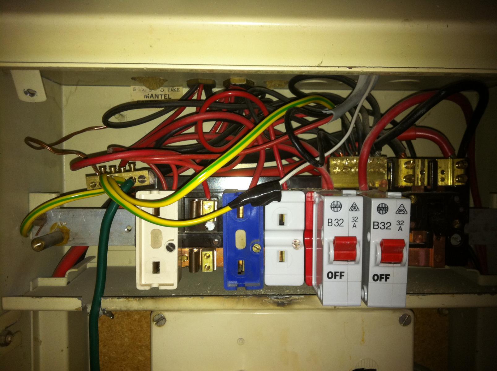

Got a call today to go to a old flat as the lady was getting shocks when she was having a shower.
She explained that when she touches the tap and then the shower unit she gets a tingle and now here daughter is getting them as well.
Considering the property is a rental I was amazed to see a old rewireable fuse with some retrofit Wylex MCB put in there.No RCD ,bit of old twisted uninsulated earth wire coming up from the supply cable buried in the wall.The fuse box was not a stand alone type unit it was integral in a metal type service cabinet about 2 foot tall.
The property has an earth 0.6 (TN-S) however it only goes to power circuits,the lights have no earth and the circuit feeding the shower pump.Pulling of a cover in the cabinet revealed about 3 cables out of 8 actually had a cpc in them.
Incoming water is bonded ,but not gas to this flat and next door.Wondering around my R2 Long lead could get no continuity on any taps ,shower.
There is no supplementary bonding anywhere,lots of plastic unions so continuity if it was there is now broken.
The shower has a pump and the boiler is a conventional type with a hot cylinder upstairs.No bonding in the airing cupboard.
Now I assume she is experiencing a difference in potential which is why she is getting shocks.I could not get any shocks with the shower running and checked for any voltage present just with my volt stick and direct measurement,non existed.

Well,I was told a builder friend had fitted a extractor fan just before the new tenant moved in.So I thought I would start there,timer control removed and powered direct to motor from light switch and bless him to save the coppers reused the ceramic thimbles,loose neutral.The fan vent just goes into loft ,not to any soffet or roof vent.Lots of old bakelite JB everywhere in loft but they all looked very good inside and the cables looked in very good condition but any 1/1.5 conductors size cable has no earth,so all lighting.
Thought I would get on with my earthing so a fresh roll of 10mm was grabbed,lots of bonding all over the bathroom,both sides of pump and then ran a length of 10 straight from MET to the bathroom,easy route most of which is lost behind a pipe so not that visable.
When finished ,still got gas to do,i thought i would take the cover of the pump to make sure the connections were all sound. Touched pump body to my nice new bonded pipework and got 24VOLTS !!!!! put voltage probe on earth post in pump and got the same.Pulled a couple of floorboards to find join and a fused spur was found fitted with a 13amp fuse.Removed cover and the earth was not connected at all,goes back to airing cupboard and a fused spur in there so god knows what else it feeds.
Rejoined earth and voltage goes,continuity from pump earth post and to all new bonding perfect.

If the CPC is disconnected I immediately get the 24 volts again between pump earth post and bonding.Reconnect CPC and voltage goes away,pump does not have to run to get voltage it is there all the time.There must be something internally in the pump which is failing.Its works fine.
If i can identify what else is on the circuit i will carry out a IR test tomorrow on it,I will do between live conductors and earth first just in case.
I'm on a day rate,so lets do it all !
Definitely sounds like there is a fault there still waiting to be found and the reconnection of the cpc/bonding is just masking it - better storyline than coronation street this ;)
