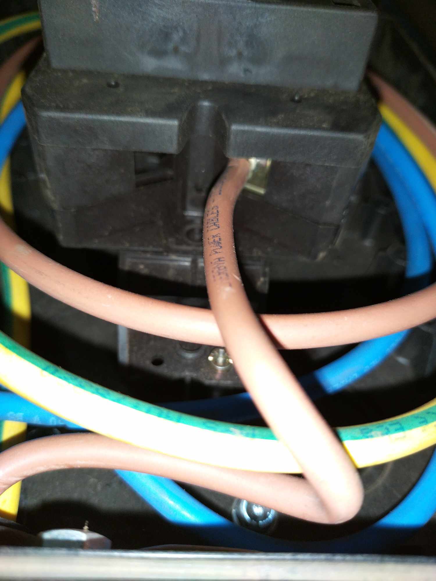

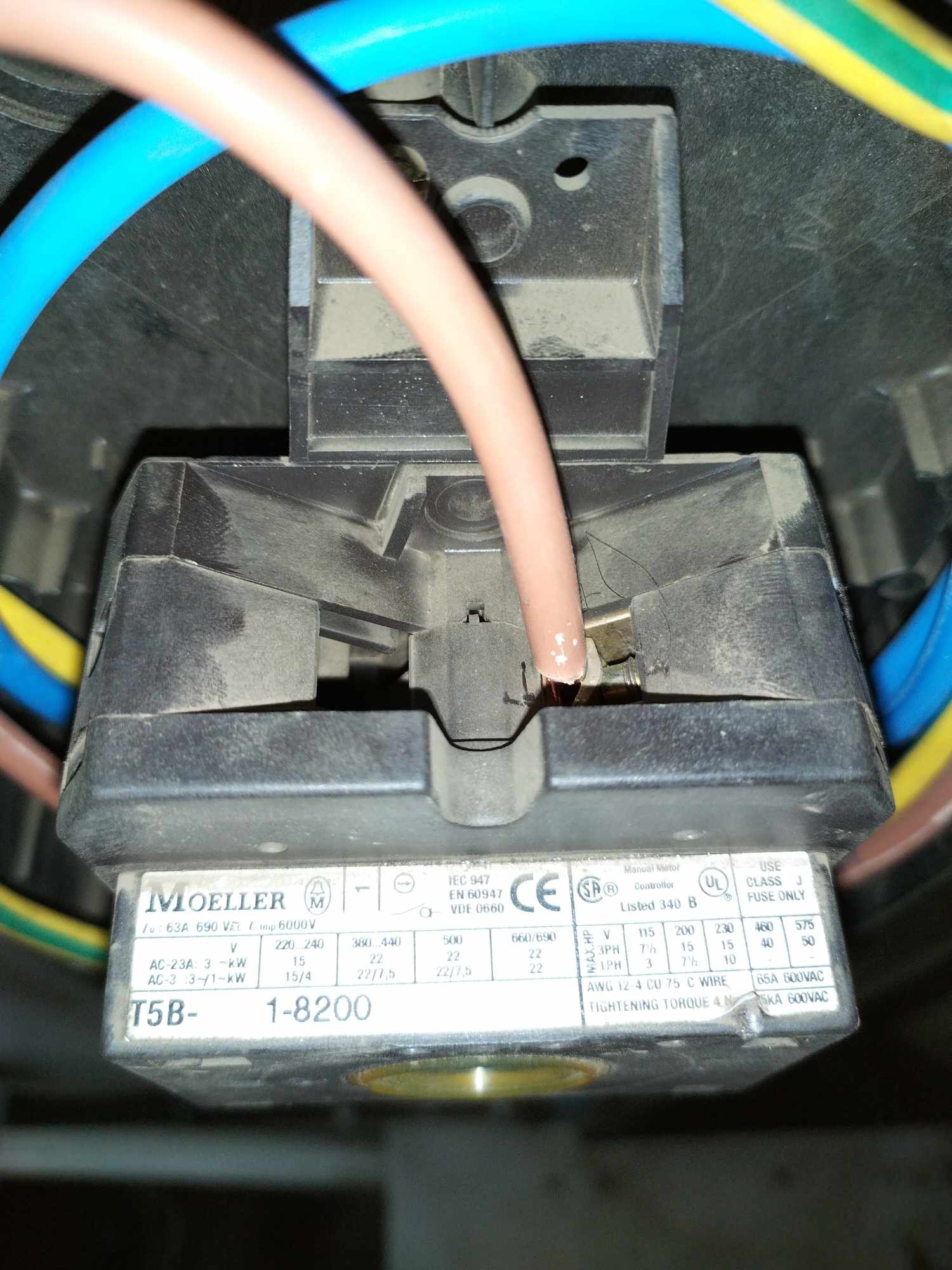

Hi everyone,
I have moved into a property with a 63a single pole rotary isolator controling a inline water heater. Is this safe? Surely it should be a 63a two pole isolator switching both the live and neutral?
Any advice would be much appreciated.
Thanks.
a high current appliance should isolate both live and neutral
The current is unimportant, as you can get just as bad a shock from a 6A circuit as a 60A. On a domestic single-phase circuit, an isolator (which you would turn off to enable maintenance, for example) is expected to break all conductors with a 3mm contact separation. A control switch need only break the line, so is it possible that this was the intended purpose of your rotary switch, and the means of isolation (if required) is something else?
Thanks for your reply, I would imagine the rotary switch would be used for maintenance as the only other way to isolate the water heater would be from the 50a MCB at the board. Perhaps I am wrong and it is just used as a control switch.
So for use as an isolator for maintenance it would need to break live, neutral and earth?
Never break the cpc!!!!!
I'd be surprised if it is a Single pole rotary isolator, more likely a Double pole but only one pole used so shouldn't be too hard to rectify.
Any pictures of the internals?
