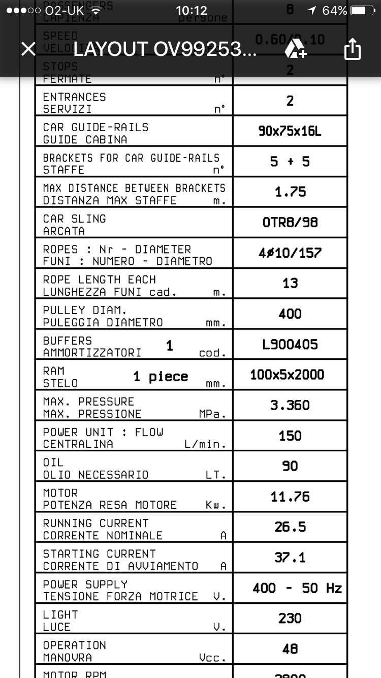

We're in the final process of finishing a care home rewire, they have a 3-phase lift being installed. Everything's in place and been ran etc...
UK power networks has just given the owner a quote of over 100k to upgrade the current supply to a 3-phase supply to accommodate the 3-phase lift.
Has anyone ever fitted a 3-phase inverter? The installation currently has a 100amp supply but the loading is minimal. The lift is 31.7amps (37.8amps start up). Can I supply a 3-phase inverter with a 6mm 40amp MCB from my single phase and then supply the lift that way.
Has anyone ever installed one before? Recommendations or advise is much appreciated.
The biggest 1-3 phase inverters I use top out at 2.2kW, you're talking ten times that size. Plus, supplying 40A of 3-ph startup off a single line is going to fully use that 100A supply, then some more.
Bottom line, if your client wants a 20kW lift motor, they need to stump up for 3 phase incomers.
A standard motor inverter would not work anyway due to the fact you are not just feeding a motor, you would be feeding controls, lighting, etc.
Only option would be a rotary converter for this type of application, but even then I do not think the supply you have available is big enough. May be worth investigating though, as UKPN may be able to increase the size of the existing single phase supply for a lot less than ÂŁ100k

Didn't he say 40A was the start-up current ?
Which is more like 10KW
Where did 22kw come from ?
22kW was off my head with no working. Looked it up and an 18kW 415V motor at 0.8pf pulls ~32A FLC, as stated in the OP. To power that same 18kW off a single phase supply is 97A before conversion losses! I don't know where he got 37.8A startup from, a heavy traction lift motor is more likely to pull 100+ at startup.

All the carriage lights and shaft lighting is supplied separately by a seperate DB situated in the corridor cupboard. Looking at the Lift document it says total running current 26.5 amps and total starting current 37.1 amps.
I was under the impression this was across phases so running current roughly 9 amps per phase, and starting current 13amps per phase.
I've just attached a screen shot of some specs on the drawings

Somebody better speak to the Lift installation company before any more plans are made I doubt they will accept an inverter supply.
