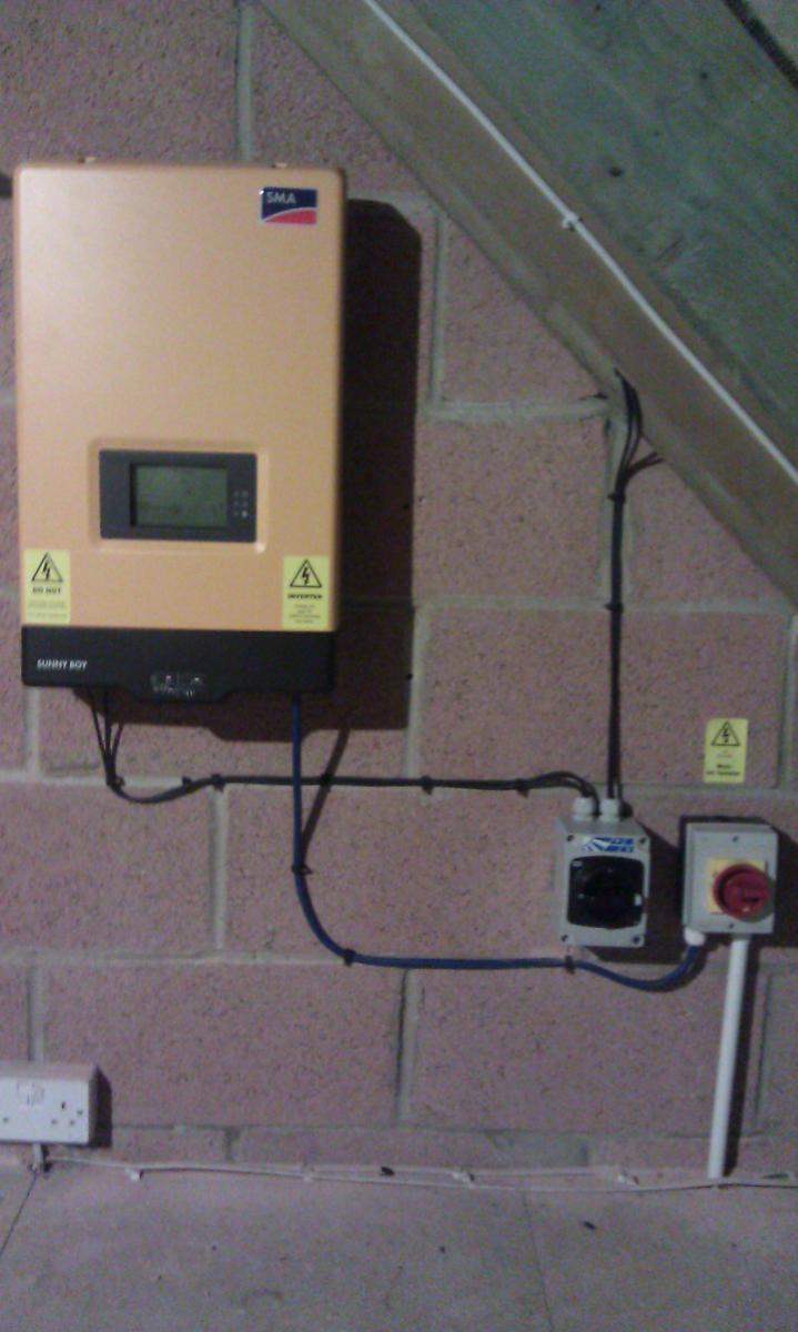

doesn't have to be T&E, you can use any suitable AC rated cable. he's talking nonsense!On his argument what would you use for a shower, after all, someone might tap into it to use for a cooker! we use flex and twin and earth depending on which would be most suitable. We use standard white flex, but in 4mm or arctic cable in blue. when we use T&E it is always 4mm or 6mm.
cornerstones.jpgArctic linking from inverter to isolator, then T&E in conduit (the conduit is straight, just perspective makes it look on the wonk!!)
