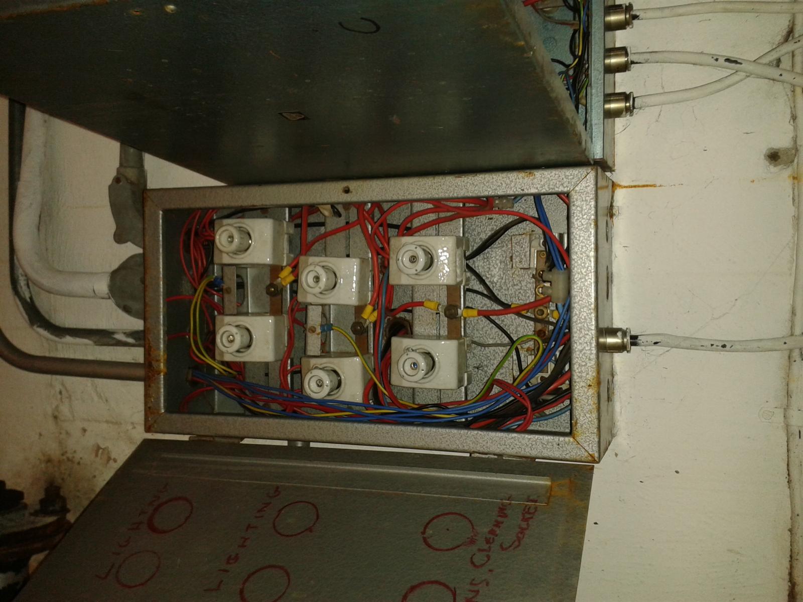

Hi just thought i would show you guys some photos of the work iam trying to replace.Photo 1 is 4core 35sq mains feed to 2 storey office block, no2 is i.5 feeding lighting in several offices this is the best photo of the circuit the rest contain old rubber,single pvc only surface,conectors junctions the complete package.Have you seen better?

The first pic on post 14 is a bank of fuses, one of them has a porcelain cap missing so the bare metal is live. I think the fuses are a German design and usually called bottle fuses because of their shape.
A lot of older continental made machines used to have them as part of their control circuit. The last "new" machine I worked on a couple of years ago (retied now), had mcb's and electronic control so it's possible they're being phased out
I've seen big Italian woodworking machines (Morbidelli, etc.) using banks of these. And frequency changers to get them saw blades spinning nice and fast. Daz
