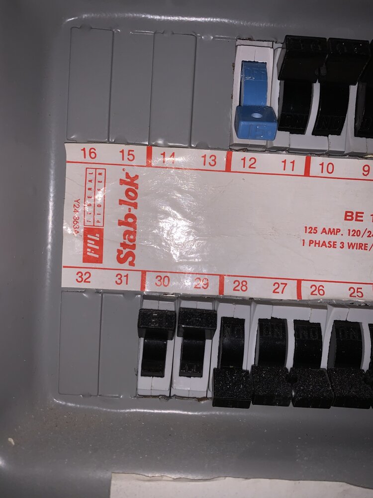

Is a stab lok panel as bad as Everything I’m reading online ? Or just some of them?
Moved into a 30 minute year old house and wondering if having stab lok is reason enough to change the panel ?
  • [ElectriciansForums.net] Stab Lok

But it is 30 years old, you probably can't get spares for it should something break, and I don't see any RCD protection (GFCI) against electric shock (though in some cases that is done at end sockets - here in the UK it is usually done at the panel in all places wired in the last decade or two).
Those are 3 good reasons to look at replacing it!
Check out the local electricians to find those that are decent (good reviews, folk who have used them before, membership of professional bodies, etc) and get a couple of quotes for a new board.
If the rest of the house is in good condition (no damaged cables, sockets intact, etc) then you don't need a rewire, just a modern board for peace of mind.
There has been much written about the reliability of Stab-Lok devices failing under fault conditions. In the US they are called Federal Pacific and the UK version made by Federal Electric and ECC (related companies) are a direct copy. In Canada they are called Federal Pioneer and are made by Schneider, still available. There was recalls of Federal Pioneer with Schneider replacing them for free, recalls were for the blue toggled devices with replacements having a hole through the toggle, in your picture the blue toggle one is indeed a replacement (has a hole through the blue toggle).
It is not clear how true it is but the good folk in the testing house at Federal Pacific were apparently not honest about the performance of their devices and later tests show a high failure rate however, I don't believe the same can be said of the Federal Pioneer brand by Schneider.
Twice I've seen federal MCBs in the UK not trip under dead short conditions, the circuit only breaking after the copper at the fault location burned back enough that the arc extinguished. I wouldn't want that panel in my house.
Personally, if it was my house, I'd replace it.
I don't like them, I don't trust them.
In a customers premesis it's a little trickier, I can't just recommend replacing a DB based on my personal opinion. I'd certainly encourage then to replace it though.

I don't believe the Federal Pioneer made by Schneider in the OPs board are so unreliable.
