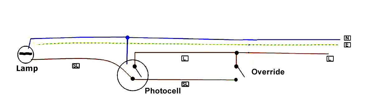

Hi all hope you can help can you wire up a steinel sensor for outside light and have an over ride switch if so how do you wire this up many thanks
Wire the photocell and switch in parallel to the lamp.
Diagram:
[ElectriciansForums.net] Steinel photo sensor for outside lights

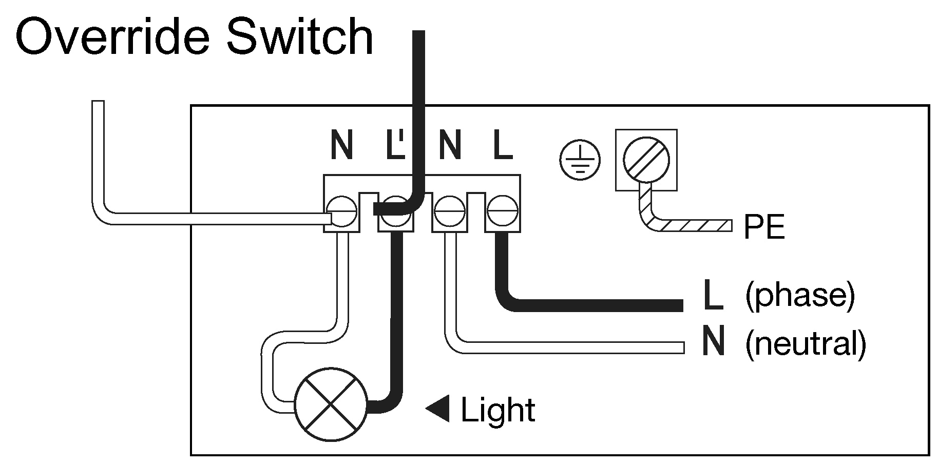

Generally yes, if you have an odd design of switch then it may have problems, but usually any photocell can have 230V applied to the off side of the switch without problems. For a steinel you may need to connect the override switch neutral to the second neutral terminal on the sensor (if it has one) that is connected directly to the lamp.
