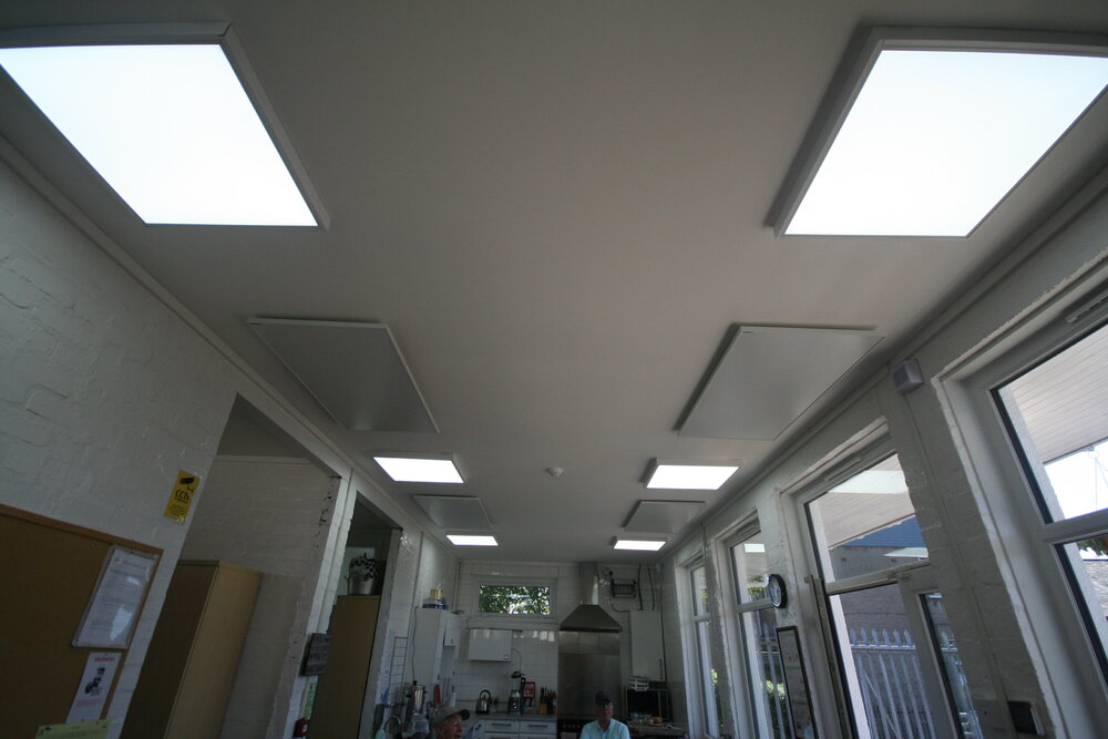

I need to put some storage heaters in a large room. It's around 50 square meters.
Energy efficiency is my number one priority. What is the leading energy efficient technology when it comes to wall heaters?
Last time I fitted some, infrared was the leading form

gazdkw82, thanks for those details about the construction of the room. From my limited experience, such construction is a perfect match for infra red heating, as it is identical to the recent installation I mentioned originally. If you can install the heating on the ceiling, that would be a bonus in a number of ways.
What are the benefits of heating on the cieling? Does it make a difference if the cieling is over 2metres high?

These are benefits from ceiling mounting:
1. The system is less visually obtrusive
2. Even if you can't get access to run the cables above it, trunking is less of a problem
3. The panels are less prone to accidental damage, such as someone pushing a chair back against a wall-mounted panel.
4. Where some users may be less able, keeping the heater panels out of touch can be a consideration.
5. The "heat" radiated from the panels is directed at the solid walls and floor, which is where the efficiency is best.
6. Not having heaters and cabling mounted on the walls leaves the walls clear and makes it easier to clean the room.
7. Those using the room who are follically-challenged will benefit from the heat from above! This allows you to run the system a couple of degrees lower.

Does it have to be a specific type of heater to be cieling mounted or can most panel heaters be cieling mounted?
I'm not sure if all types can be ceiling mounted, but the ones i investigated could be.
FYI, I finally settled on the select range from Herschel. They use a mounting plate which is suitable for wall or ceiling mounting...it takes a bit of practice, and I had assistance with the large panels, but the smaller ones were fine.
[ElectriciansForums.net] Storage wall heaters
Here's a pic of the heater panels in situ, obviously the grey panels between the LED panels
