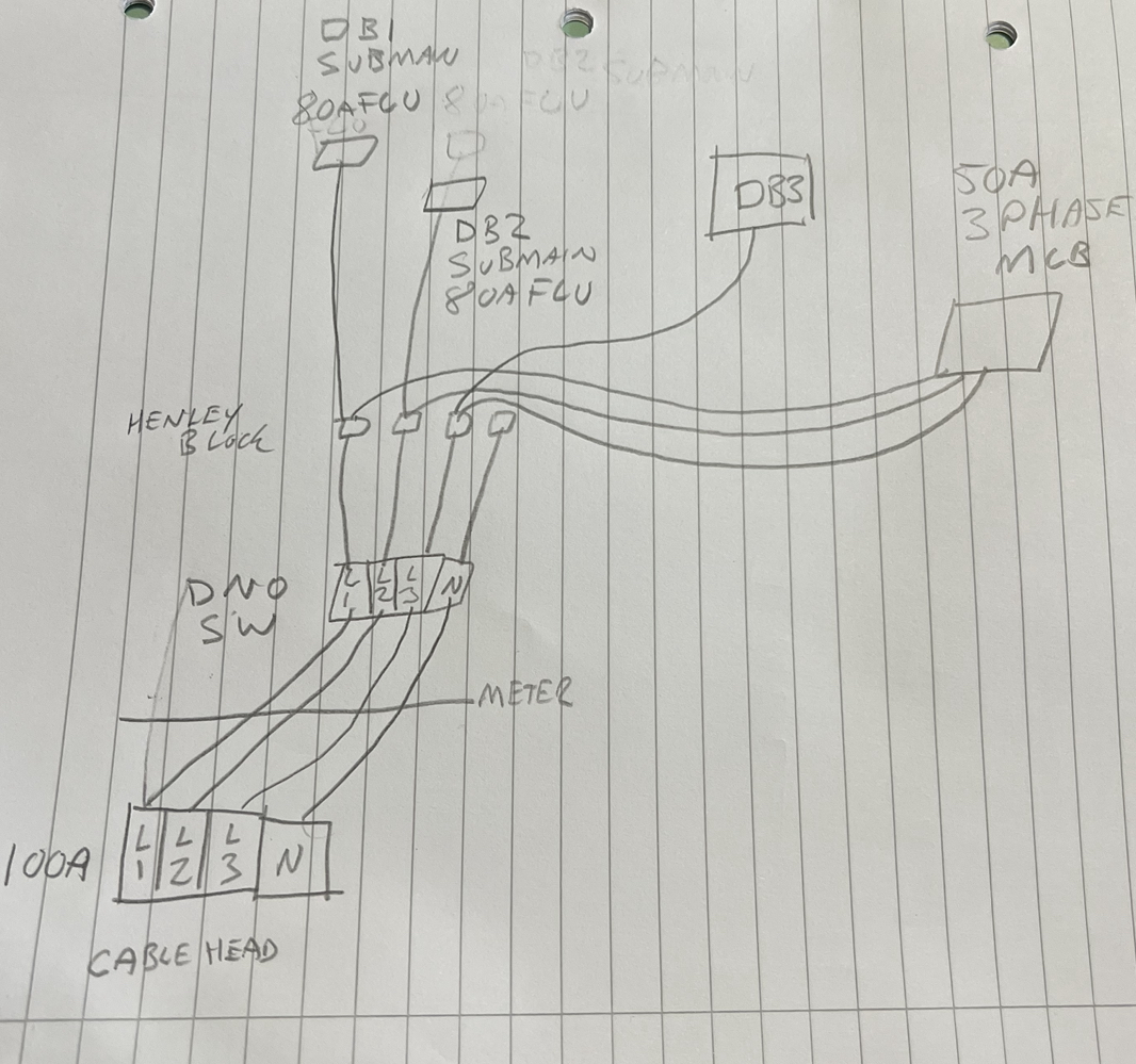

Hi all.
I have been asked to take over a job an electrician has started, and has moved abroad.
The house is a big mansion, with a 3PH supply, with 100A fuse on each Phase.
The electrician has ran 2 25mm 3core armours to another 2 DB’s in the mansion, and there has to be a DB fitted where the incoming supply is, bringing it to a total of 3 DBs.
In the plant room, there is also a 3PH heat pump.
However, my question is how would you all terminate the sub mains. Would you bring each phase into a Henley block, and branch off into a 80A switched fuse for the armour sub mains, and take a tail off the Henley blocks for each phase into a separate enclosure with a protective device for the heat pump, or would you fit a TPN board, and bring all armours into it + the heat pump supply?
If it’s a TPN board would you fit MCBs or MCCBs for the 25mm armours? Is there even
I’m a new build house basher, so this is abit more complex to what I’m used to, even though it’s a new build, so please go easy on me🤣 I am simply just wanting advice to keep me right.

I think the spark had went down the route of Henley blocks and splitting out to 2 80A switched fuses, and then splitting out to a 50A 3phase supply for the heat pump, for cost reasons to save money on the likes of an MCCB panel.
Now, I know it will look like spaghetti junction and what not with loads of 25mm tails, but is there any regs that state this isn’t a compliant method of supplying all the sub mains.
Would like to be clued up on this so I can give client all the options, and give me peace of mind that if they go with the cheap option of Henley blocks, then atleast it’s compliant.
Thanks so much for your time replying to the thread

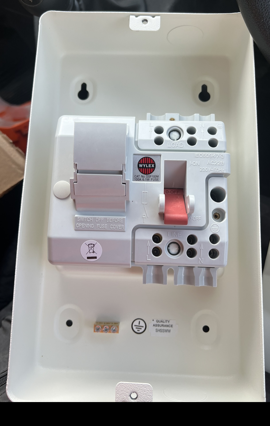

This is what the electrician has intended to do it seems to save the client the cost of an MCCB panel.. would like to reiterate its not the way I would do it, but want to clear up if it’s compliant, regardless of how messy it may seem
This is what the client showed me that he had bought for the tails to enter from the Henley blocks, and then feed the armour to the other DBS, whilst protecting the armour with an 80A fuse
There is nothing wrong with this but it looks a bit "housebasher", apologies for this. When I do a job I like to look back and think that is a good job rather than not look back knowing there was a better more professional way. What about surge protection?
Don't think you can run tails directly to a 3 phase MCB for the heat pump, would need some kind of main switch as well wouldn't it. Why not fit a small 3 phase board for DB3 and run the heat pump from there, maybe a type A board if it doesn't need to be too big.

I had thought about a TPN board, but was wary of the fact one of the DBs the 25mm armour feeds has a 10mm shower circuit, 10mm induction hob circuit, 2 ovens, few rings circuits, few lightening circuits etc. So 63A on the armour may not be acceptable?
Do MCBs not go upto 63A max? Would the above load on the DB not potentially pop the 63A? MCCB panel sounds more appropriate as you can use the 80A MCCB to give it some more juice, but it must’ve been too costly for the client, and that’s why the spark had bought the 80A switched fuses

Dunno, thats where design comes into play. To expand on the similar install. Although it was TPN in the plant room, because of the length of cable runs and TP loads, I had TPN board in plant room, submain TPN board on first floor, feeding 2 SPN submains also on first floor, TPN board in garage (submain off plant room) so for the house there were 5 DBs in total (and they were all stacked) - I think your concern about loading one phase up to 80A and they having a heat pump at 50A (bearing in mind how long there cycle is) maybe a bigger issue. Anyway its all about the design...
You get some 250A TPN boards that take a mix of wide 80-125A MCBs, and normal (17.5mm width) <= 63A MCBs from Hager. But you won't get decent selectivity that way with downstream DBs.
Going for a MCCB board would be the best option as then a incoming switch for all, and easy choice for any out-going protection from tens of amps upwards, along with reasonable (typically kA-range) selectivity on faults. Ideally put your SPD in there.
Fuses are good in many cases, but a busbar chamber and switched-fuses coming off is a bit of work and not likely cheaper than MCCB board, and MCCB boards are far easier for anyone to reset or to isolate stuff as needed,.

Why not just put a 6 way Ryefield downstream of the DNO incomer? Gives you a box to gland into, choice of fuse sizes and a better disconnection time. 2 ways for the subs, 3 ways for the plant room (which I'm assuming will need a 3ph board in it regardless) plus a spare for the future.

Mcbs are not likely to achieve selectivity. Using such devices for distribution is a poor design.

That is why fuses or MCCB are the best choices, then the Ryefield or MCCB panel choice usually comes down to likelihood of a trip and need for non-skilled folks to reset.

Once you get pas the slow thermal trip side, many MCCB have a short-delay aspect (sometimes adjustable) of 20ms or so at modest overload currents, then once you hit really big faults in the kA range they go on an "instant" trip in the 10ms or less region to energy-limit the fault, just as MCB do.
It is this short-delay aspect that gives them decent selectivity with MCB that all go "instantly" as soon as you get past the thermal limit. That is one major advantage for applications like this where you are feeding MCB/RCBO boards.

If it is feeding sub-mains so 5s disconnect and all 63A or above it makes a lot of sense.
But I think there is at least on 3P load for a heat-pump, that would be better served by some 3P MCB or similar so on fault all phases go down. Still a DIN box and MCB from a set of fuses is still quite a viable option.

Thing is, it's never just a heat pump, is it. It's some local sockets, a light or two...... so my choice would be to supply a small 4way 3ph board from said Ryefield. If you're building a plant room, build a plant room! Not some abomination of tails spaghetti.
Not sure if I’ve understood this properly, but it appears to have parallels with my own installation. I highly dislike the idea of feeding SP sub-mains from a TP board, unless for very small local loads - which are not likely to increase in the future - like, maybe, a garden shed. I would never even consider a single phase 80A sub main.
For anything else I run 4 (or 5) core SWA to additional TPN distribution boards. Then you have the ability to properly balance loads between the phases, and to run any future 3P loads.
