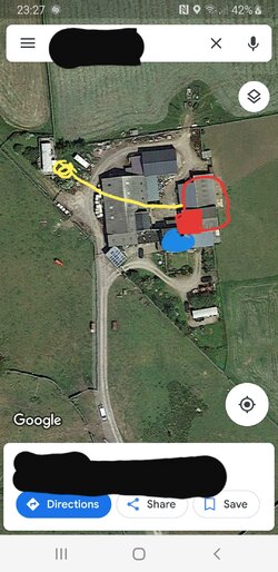

Despite what seems like a significant load, looking at the current overload protection/current consumption characteristics, I think the 100a fuse might just work. I propose on using 25mm SWA as the submain to the workshop where I will terminate it in a locked cupboard with tails out to the workshop CU, before continuing the 25mm submain to the new farmhouse CU (when constructed).
I'm trying to thrust bore the SWA under the other barns/sheds on the farm, but I'm not sure it will be possible. Therefore it would have to run 20m underground ducted, 60m through 3 of these buildings (clipped direct) and 20m underground again. My question is, would I be best using the PME to protect the SWA (isolating it from the workshop/house CU) and using electrodes to provide TT at the house and workshop as it is a farm with livestock? I will leave the TT installation at the caravan of course. I believe I will also need to protect the submain with a 300ma RCD for fire protection due to it running through farm buildings, despite the supply not being strictly, "agricultural". I will of course protect the submain from overcurrent with a FSU adjacent to the meter cutout.

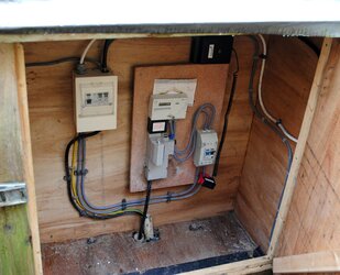

View attachment 49091 View attachment 49091 Picture of current meter cut out/submain to static caravan.
Aerial photo showing static caravan/meter cutout in yellow circle, with the yellow line the submain, red circle the workshop area, and red blob the proposed new farmhouse. Blue blob is the existing farmhouse on a separate meter and supply (but same pole mounted transformer supply.)

Steer clear of the PME the 300mA rcd with be OK for the sub main protection
Would I not need any form of earthing to the SWA sheating at all? Even an electrode at the cut out (though the equipotential zone of the electrode may 'overlap' for want of a better word with the static caravan electrode. I suppose all consumer units at the end of the submains will be protected by 30ma RCD's and TT'd, so the sheating will not be required for the earthing or fault protection anyway.
I assumed there was an electrode as there is a bit of g/y going somewhere, if not put a stake in or bury a length of bare 25mm in a trench
Talking to the customer, he believes that the previous installer put a stake in to TT the SWA submain to the static caravan (submain earth isolated from the caravan C.U.), and then a second stake was put in for the caravan C.U earthing and bonding of the chassis. I was unable to see the stake for the C.U. earth/bonding as there is a veranda/decking all the way around. I think I will have to chuck the chickens out and crawl under in to the abyss (great!!!).
