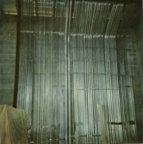

thats a whole lotta pipe work, i take it you don't use a lot of trunking, tray or ladder racking, very neat though
Not really. It's permitted, but just not used that much. The only time an electrician here would use cable tray or ladder racks would be in factory work, where the factory will be re-tooled and rearranged on a regular basis. For something like a school or hospital, where things will remain pretty much original for the life of the building, it's all piped. Matter of fact, that second picture above is the headwall (head of the patient bed) rough-in wiring for a hospital surgical recovery room. That's why you see some copper pipes going to what look like electrical boxes. Some of them are oxygen lines, some are ordinary air, and some are suction lines. I'm not sure which is which. I just mess with the wires. :)
looks like if I ever wanna work in the US im gonna have to work on my conduit skills lol
That's a fact. Homes are still just done with cable (with the noted exception of New York City and Chicago, where pipe is the rule), but commercial and industrial work is largely all conduit work. Armored cable is making inroads in commercial work in a big way here lately. Armored cable is permitted to be used in most places where conduit would normally otherwise get used; it just looks uglier.

nice pictures sooo much tube :eek:
it seems so very strange to me that you dont seem to combine it with trunking
also a good job with armoured can look very good and neat if done properly
