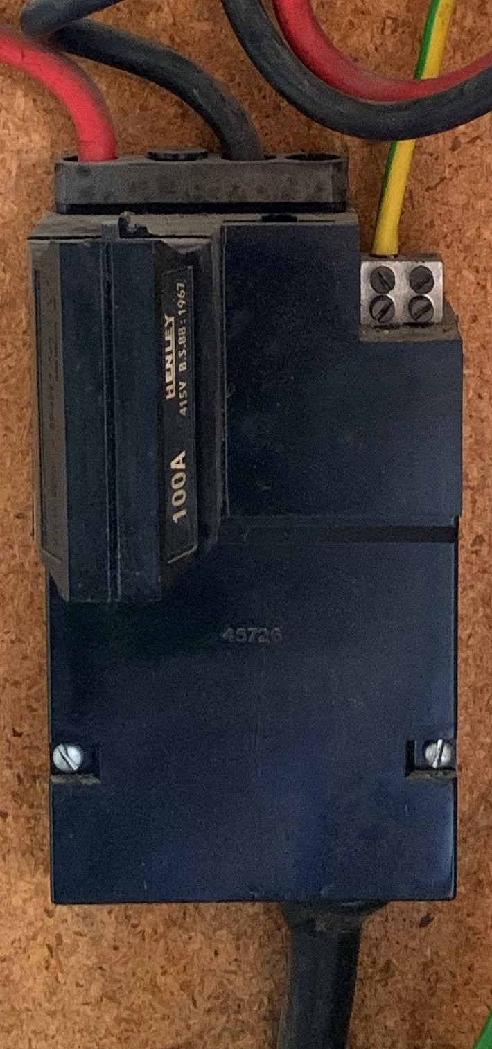

The attached photo shows the suppliers head that includes an earth terminal.
The incoming supply cable is a single phase plastic sheathed cable containing L & N.
The earth terminal is not actually connected to anything (not internally linked).
The DNO is SSE.
A previous contractor was under the impression this was the suppliers earth and used it for earthing.
However, they did leave a comment that the earth impedance was "a little high"!
Historically the property was TT, but there is no longer any sign of an earth rod etc.
This is a fairly old property, now with a number of somewhat less-old properties nearby.
Likely the original supply was overhead, before the area got developed a few decades ago.
Question:
With this head fitted, with an accessible earth terminal, would it be correct to say the DNO has supplied an earth?
And in which case they should maintain it?
Or are there circumstances when this head would fitted but with the earth terminal not connected?
Ideally one would simply ask SSE what type of supply is available, but this seems to be proving difficult.
If it is reasonable to say this should be a supplier's earth, I'm tempted to log a call to say the earth appears to have failed.

Thanks for all the replies.
Opinion seems to vary, and I'm veering towards the customer just asking for the earth to be checked, perhaps giving enough reason to get this done urgently (rather than in 6 weeks), and see if it can just be internally linked there and then (I suspect it can).
If SSE won't provide the earth, then I'm going to have to fit an earth rod, and the front outside (everywhere near the intake) is all block paving, so rather hoping I don't have to!
If the customer rings SSE and tells them a electrician has reported there is no earth coming into the property they will attend ASAP usually within and hour or two
Regulation 24 (1) ESQCR requires the DNO to maintain their earth, they have no choice in the matter. Having said that I have found that the DNO for my area always respond promptly on these matters so no real need to go in with the big guns. Clearly no earth or a high resistance earth is a danger sufficient to phone the DNO on the spot and get them to sort out the earth. It looks like it is a simple matter to rectify so no need for hesitation on the matter.

Update to original post.
SSE attended earlier this week. I wasn't there and initially they said the connection was fine, it was a PME supply. The customer had to insist it wasn't, so they opened it up, muttered something about the earth being in the wrong terminal, and reconnected it per the updated photo.
Ze now measured 0.23 Ohm.
Perhaps needs a warning label that the "earth" terminal is not actually earthed?
