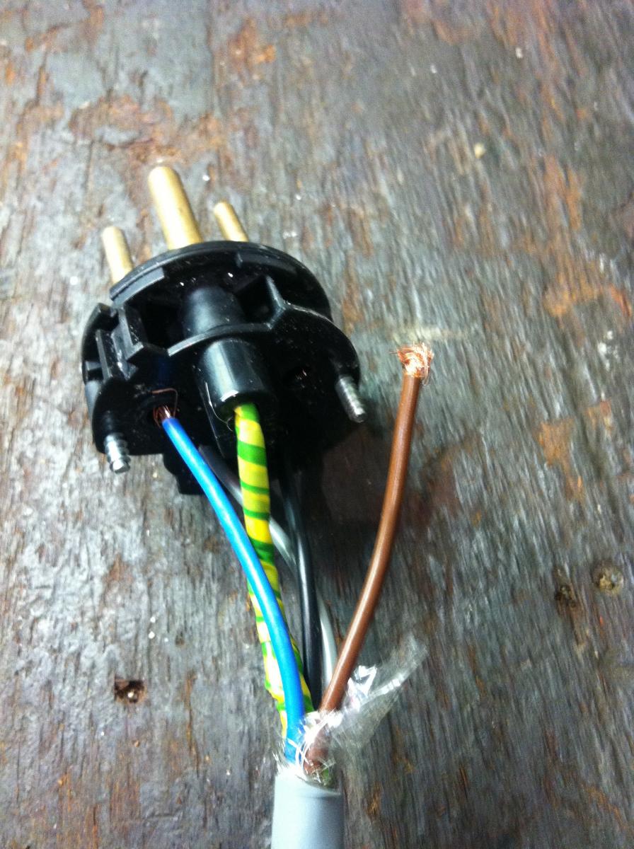

However, I often see SY badly or incorrectly terminated at these plugs.
The "flex" is protected by the 32A anyway.
By badly terminated, do you mean like this? [ElectriciansForums.net] Supply Cable Size and correct socket ratings!
One i found the other day, the machine had lost a phase and i found this in the plug. You can't see on the photo
but there was only 2 strands holding the wire in. & the neutral was about to fall out as well.
At least it wasn't the earth... this time!
