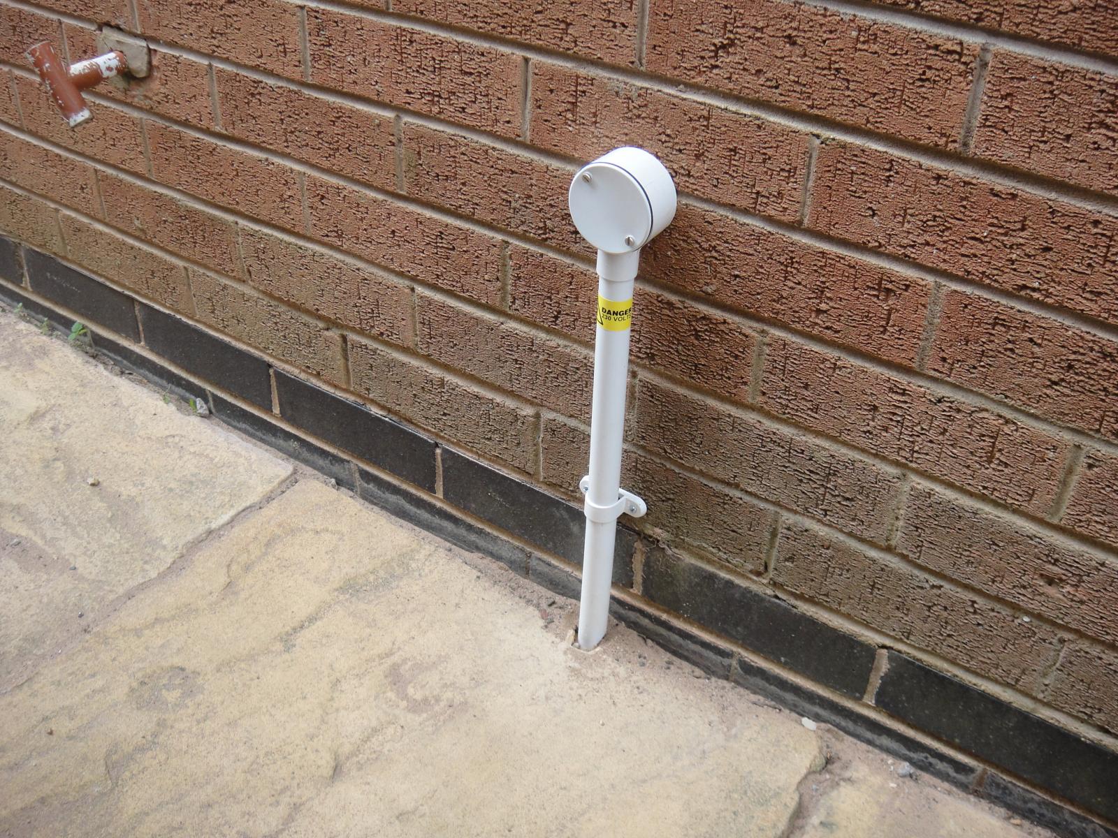

Do I feed the SWA inside some 25mm conduit through a terminal box, and terminate the three conductors in the back of the FCU on the inside and disregard terminating the armouring as its already terminated in the garage? This seems ok to me but have a feeling there's a reg somewhere that suggests it should be connected supply end. Although it will be ok and personally cant see anything wrong with it, what do you feel? It would be the neatest job. See photo below of one I did before, but the armouring on that was terminated inside, but this is what the outside would look like.

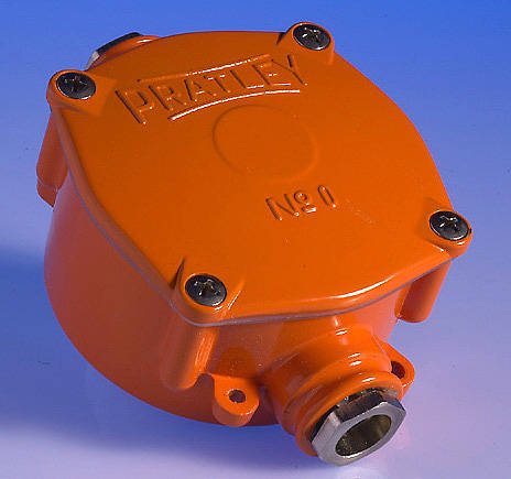

Or... Option Two

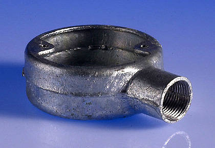

The other option is to take the armoured cable cleated to the wall glanded into a galvanised round joint like below with a rubber gasket. But not sure having never used one, is it possible to take a earth lead off of the metal? Or the other option along these lines is gland it into an adaptable box which I think might look ugly.
[ElectriciansForums.net] SWA 1 Way Terminal Boxes etc..
or this one I prefer, but don't know if you can get a link from the housing?

Thanks, that was something I was looking at as have used them before in different situations, but thought it might not look quite so estheticly pleasing to the customer that's all and was looking for something a bit more tidy looking if you know what I mean.
Yes, there is a tapped hole in the back of a metal BESA box for a screw to connect an earth lug. For external use, fussy people like me give the fixing and rear entry drillings and outside of the earth screw hole a spray with cold galv, and seal the fixing screw(s) with silicone.
wiska boxes look tidy enough for me, black ones look good with black swa gland attached to them.
for sure it look much better than existing crappy plastic conduit (not even ip rated!)
only problem they are plastic so bit tricky terminating bigger cables in there. would prefer to use metal ones.
those metal boxes look nice, only thing i`m not sure how to cover the un-used cable entries.
