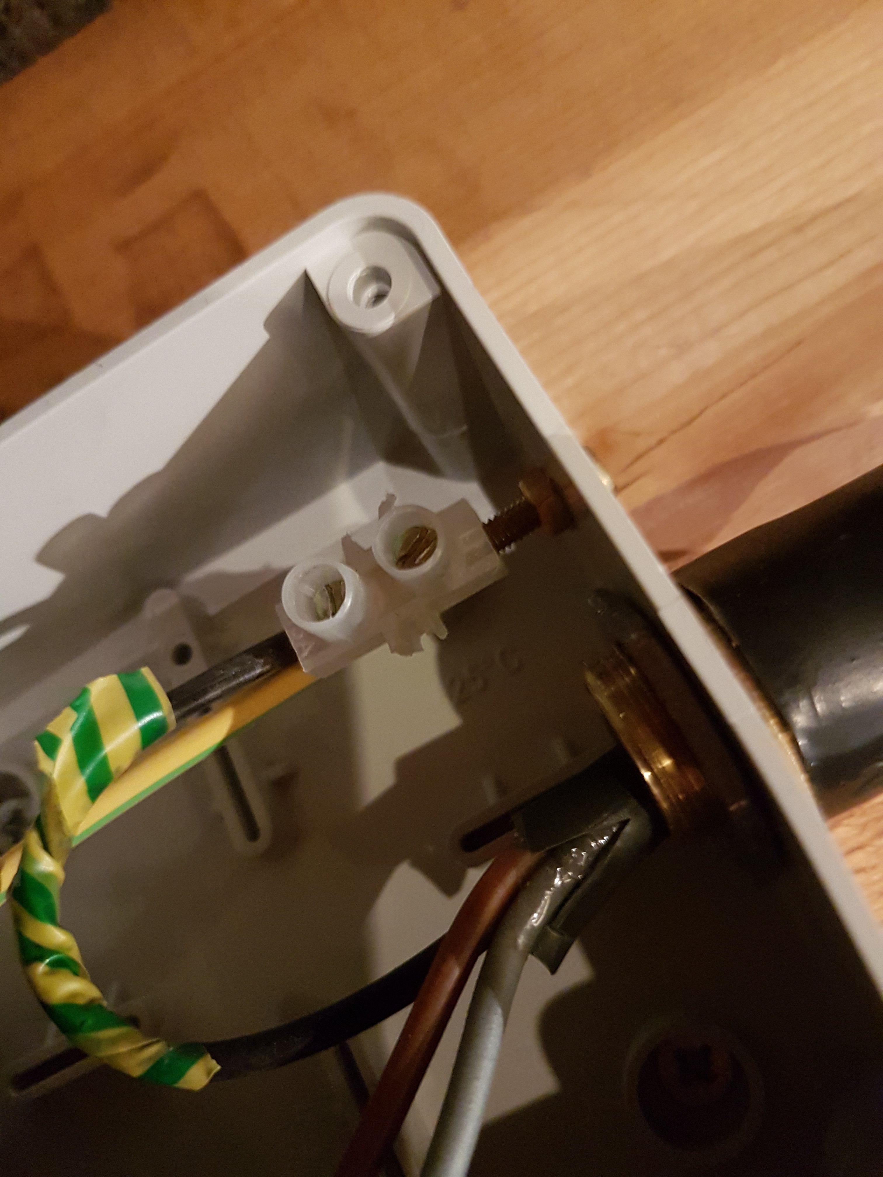

Hello everyone, having a debate with colleague, concerning SWA connected into metal CU. Can anyone advise the exact reason for the banjo, brass washer with cpc tag, is it compulsory rather than it just looks nice.
Any thoughts sound reasons would be nice also is it a requirement under the regs?
