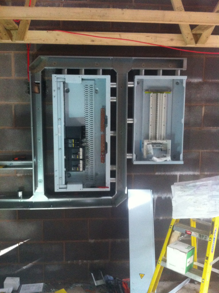

Wot I like doing if I have a metallic db is i allways if possible have peace of trunking above dis board gland and banjo all swa's to the trunking ( no earth tail to each banjo in the instance below if I were to gland swa's to a db solely probably would earth tail each ) and usually earth the trunking via the banjo of the supply swa . I always remove paint as tidy as possible at db side when glanded directly .
[ElectriciansForums.net] SWA cables and banjos!
I trust the trunking to to supply a reliable sound interconnection of earth between glands but yes have a earth tail to trunking usaly same csa as MEC .
