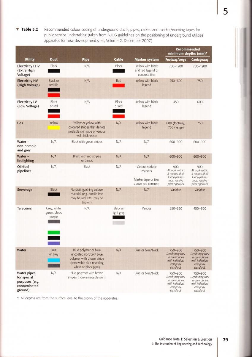

Hopefully just a quick question really, i need to quote to install some cable to go around the outside edge of a large rounded driveway, it will be sunk into the ground but at what depth?
Ive looked online but see different depths quote, some 450mm some 600mm and some completely different.
Just want to make sure be any work starts.
Thanks,

Yes, ...minimum 600mm direct buried, 450mm in an approved duct!!
EDIT .... Are you under some idea that domestic cable depths are not as stringent as for other locations?? Actually domestic garden depths are considered ''medium to high risk'' because of the likelihood and/or frequency of homeowners digging etc.
sorry thats not in the regs after all your signing a certificate to sy the instalation complies to BS7671 so surely you should know 522.8.10 ' be at a sufficient depth to avoid being damaged by any reasonable foreseable disturbances of the ground'

As far as this depth thing goes, whilst there is no specific reg about about depth of cables in the book, there are regs about protection against mechanical damage, someone will be along to quote reg numbers soon, which you need to take into consideration.

Sorry mark was using internet to find it, i'm 100% domestic only so don't have GN1 or need it on my assessment and as your aware the GN is applicable to 17th so you should be able to quote the reg
thats my point you know the bit you still haven't answered whats the reasonable or forseable disturbance that cable is subject too which means it needs digging to 600mm where have you got 600mm from whats the regulation after all you've designed and installed this?
A standard electrical installation is normally considered to have a working life of at least 30 years. So unless you can reasonably say that, ...that lawn will not be disturbed or removed over that period of time, you have no argument!!! Over the course of that time period, the said property could have changed owners several times. I would doubt very much if any of the newer owners would have any idea of your cable routing. Hence we have termed safe cable burial depth's that we abide too .... More often than not, they Work, and work very well when adhered too!!!

Well if you went ahead at your suggested depth and something tragic happened and traceability comes back to you its pick up the soap time.
However if you work to this and use warning tape you can at least defend yourself.
