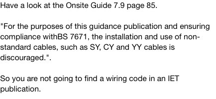

What ? not one of the 70 odd views have an opinion, I have posed it as a Q on the NICEIC Tech helpline I will post the answer here later

SY cable is not for sub mains, not recognised in the regs.

Just to be pedantic, the onsite guide is a guide that only discourages the use of SY.
It is not a statute law forbidding the use of SY.
Check the on site guide then..... this is from an older version but it’s probably just as correct today well maybe not on the page number
The on site guide is not the regulation, it is a guide to the regulations.
I stand by my point that the regulations do not ban specific materials, they specify the standards to which the materials must comply.
I'm not suggesting that SY is ever compliant, just that it is wrong to say that it is specifically prohibited by the regulations.
I agree with you Dave I was mistaken and thought it was in the BYB or BBB when it was actually the little one. Sod using it though if the OSG says that which is published by the very organisation which publishes bs7671 id err on the side of caution.....
