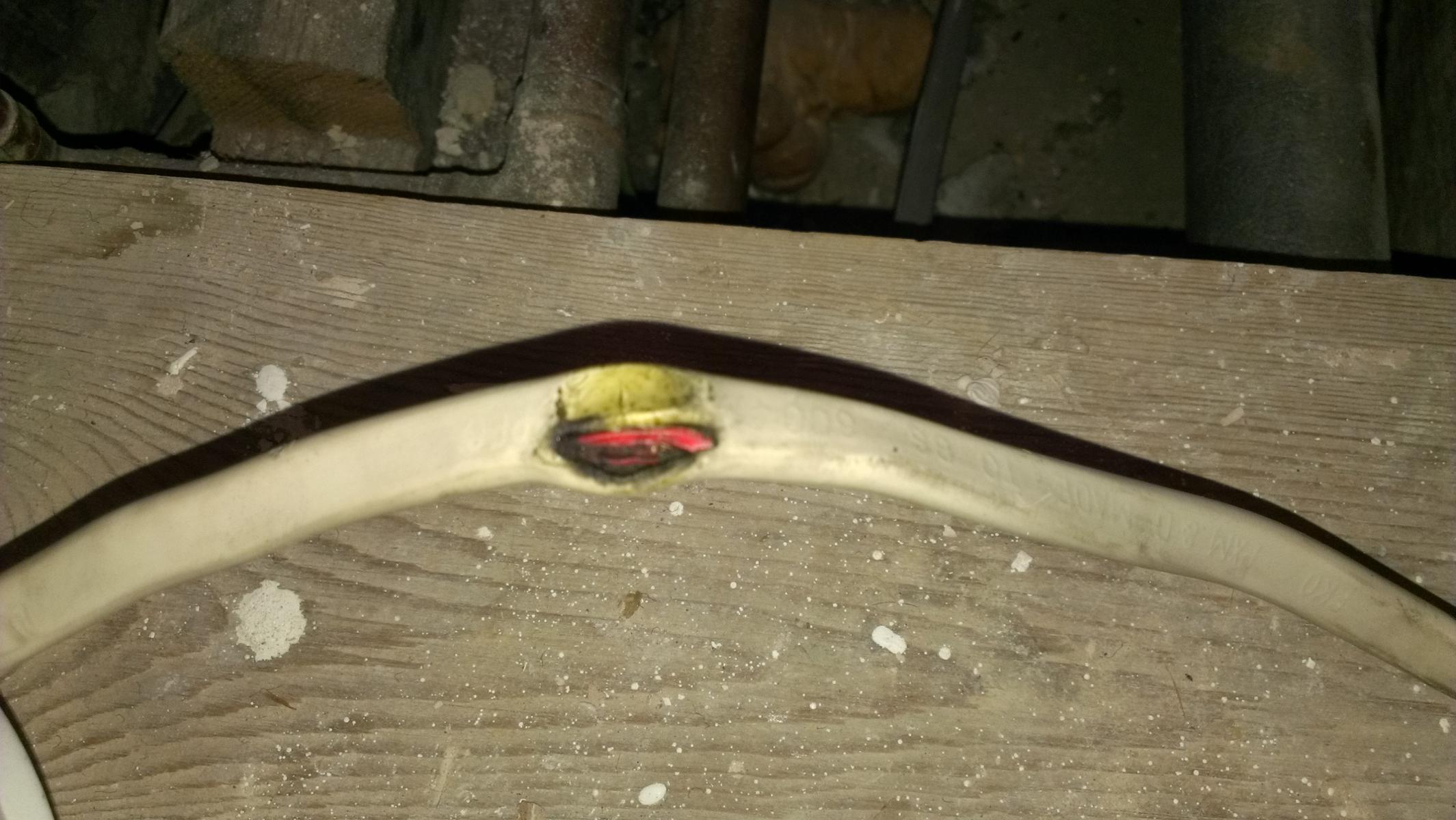

Had a good un the other day. Tracing a fault on a socket ring, we were belling each leg out, line to cpc, to determine which cable went where. One piece only had continuity when my mate bounced up and down on the floor a metre away from the socket. Cable had been trapped between the floor board and a hot pipe.
