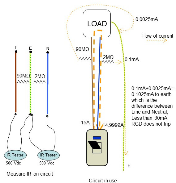

Apologies I know theres been a few threads about this and IR tests, but I'm still somewhat confused.
The way I understood how an RCD works is it measures the current flowing through the Line and the current flowing through the neutral on the return. If there is an imbalance of more than 0.03 amps (30mA RCD) due to a fault to earth then the mechanism recognises this and trips the RCD.
Some of the other threads say that as long as the IR test is over the 2Mega ohm (regs limit) then when you fit an rcd it will be ok because thats way over the limit before an RCD trips but I just wanted to clarify that if the RCD works on a difference of currents then surely you could have over 99/299 Mega ohm on L-E and N-E and that still wouldn't guarantee fitting an RCD wouldn't trip the circuit because it would only take around 8000ohms (0.008 mega ohm) which wouldn't show on most IR testers?

Hi Andy, sorry so what I mean is, obviously if on an IR test the result is showing under 2 or even low then thats not a good sign however if the test is showing over 99 or 299 on both L-E and N-E then does this actually show and RCD wouldn't trip as I was under the impression an RCD measures the difference so in theory if the IR on L-E was 99Megaohms and the IR on N-E was say 96 or 97Megaohms then because there is a difference of 2,000,000 ohms would this not still mean an RCD would trip? Or am I misunderstanding RCD's?

Hi Richard thanks for your reply, i'm still a little confused though as like you say if the RCD measures the difference of 30mA so 7667ohms, if you measure 99 megaohms between L-E and 98/97/96 between N-E then because the 2mil or higher ohms difference would that not still trip the RCD?

That's not how it works.
Are you thinking the difference between ir reads line to earth,and neutral to earth cause the trip.
This is not the case.
It's the difference between flow through line and flow through neutral.

IR testing L-E and N-E is measuring the resistance to earth.
Based on the resistance measured this indicates the current that may flow to earth.
Normally the high values of Insulation resistance mean a tiny tiny current will flow to earth, not enough to trip an RCD.
The differences between IR readings are just showing you two different resistances the relation between them is immaterial.
I have drawn a diagram that may show you what I mean.

Richard thats fantastic thank you, I get it now, so even though there could be a huge difference in resistance when translated in mA it is such small amounts of current it's negligible to the RCD and nowhere near the 0.03mA imbalance required to trip it?
