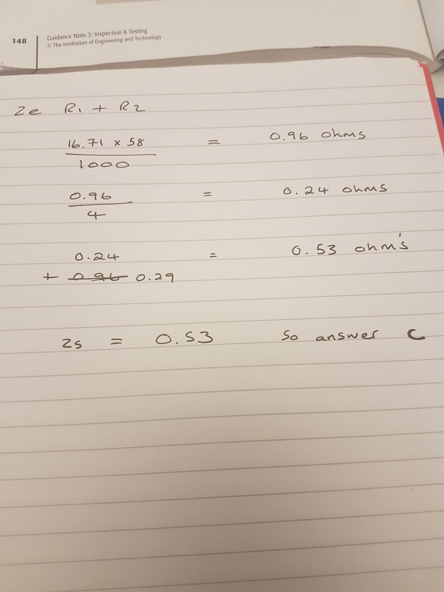

Continuity of a ring final circuit has been tested as part of an initial verification of a new primary school. All the sockets outlets are connected directly to the ring.
The circuit loop length is 58m long wired in 4mm2 live and 1.5mm cod flat profile cable.
The circuit is protected by a 32 A BS EN 60898 type b circuit breaker
The installation has a measured ze of 0.29 ohms
What is the expected as for this circuit?
A. 0 24 ohms
B.0 28 ohms
C.0.53 ohms
D. 0.58 ohms
I've done some calculations but I'm not getting any of those answers which means im doing it wrong.
This is what I have done
Zs = ze + R1 + R2
16.71 x 58 /1000 = 0.96 ohms
O.29ohms + 0.96 ohms
Zs = 1.25 ohms
Obviously that is not right
You have done it as a radial circuit not a ring final.
Have a look through, compare against yours and see where you may have gone wrong. Come back and tell us once you've figured it out (where you went wrong, not the answer)

Remember when the ring final is connected your resistance is halved due to double csa but the distance is effectively halved.

Just remember to be methodical, helps to give sources too; Table G1 for R1+R2 values, Table G2 for the multiplier etc, it helps it get enground in the mind.
