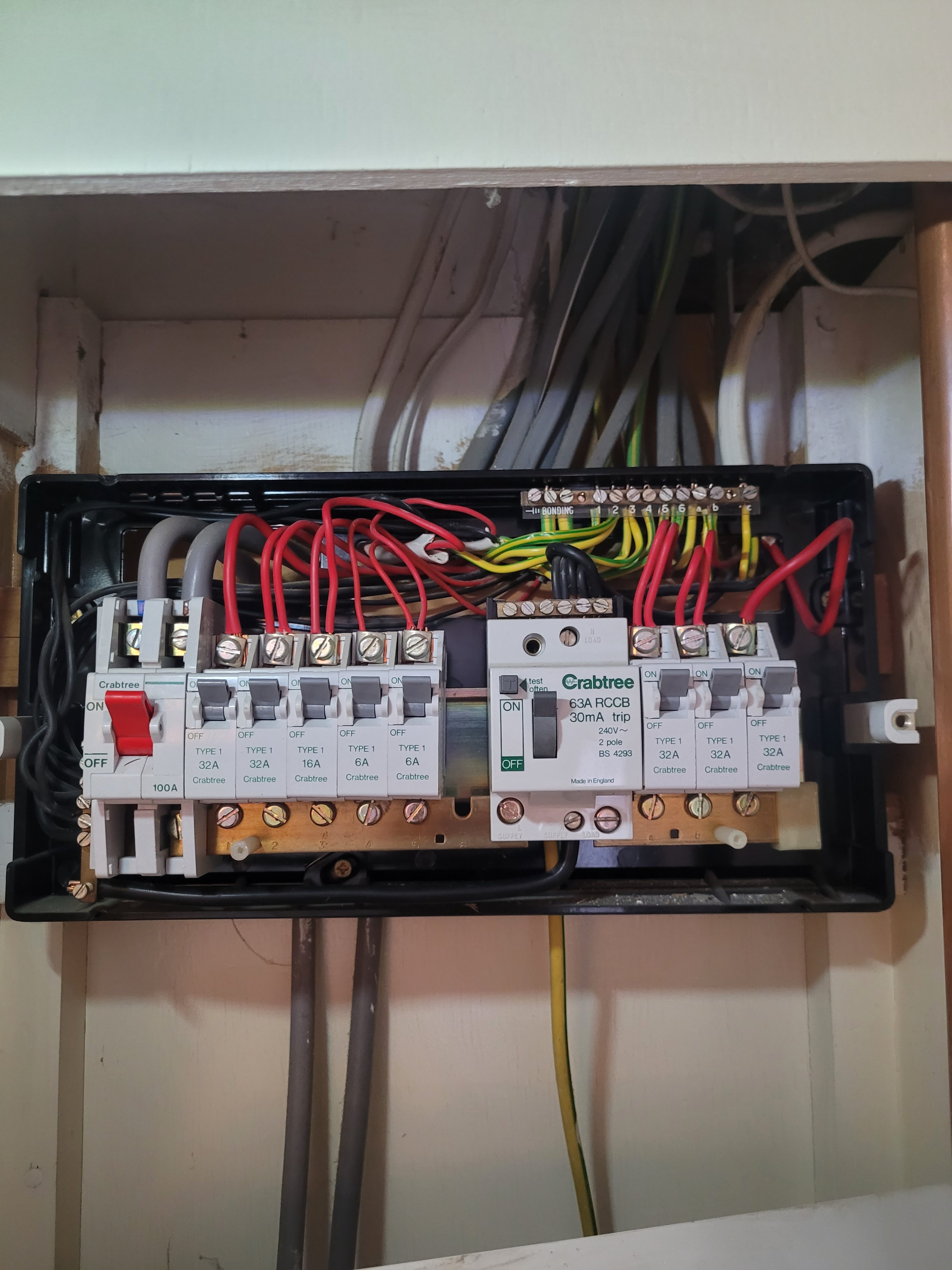

Went to test RCD with MFT at the socket. My meter alarmed and said reverse polarity. I then checked the connections, they were correct.
I then put my little plug in tester in and it showed something was wrong but doesn't say what. (Look at picture).
Baffled. I then check polarity at the board and the meter. All good.
I plugged my plug in tester into all sockets in the house. I had the same warning in every socket. This tells me the problem is upstream. But everything seems fine 🤯

I'm rashly assuming that you've checked the incoming tails at the CU aren't reversed?
That’s the only bit we can’t visually check…. Meter to cu.
You can trace from the cutout fuse to meter… and from mainswitch to rcd within the board.
From the supply side of the mainswitch, what voltages do you get L-E and N-E?
Is it only the sockets or are other circuits affected?
If it's only the sockets I'd be looking for a junction box very close to board.

Are the neutral legs going back to the correct neutral bar?
This is where a decent long wander lead pays for itself!! However - correctly done fig8 tests should also reveal an issue on an RFC (which I'm again, rashly, assuming is the case?). Use a plug in socket adaptor and a long lead back to the board and simple continuity tests will narrow this down before your cuppa's gone cold.
I had a case like this where all the sockets (keyswitch) were wired L-N reverse from the manufacturer (we think).
In this case if polarity is correct at the Consumer Unit a wander lead can be used to check L N E at each socket to the disconnected Consumer Unit cables
