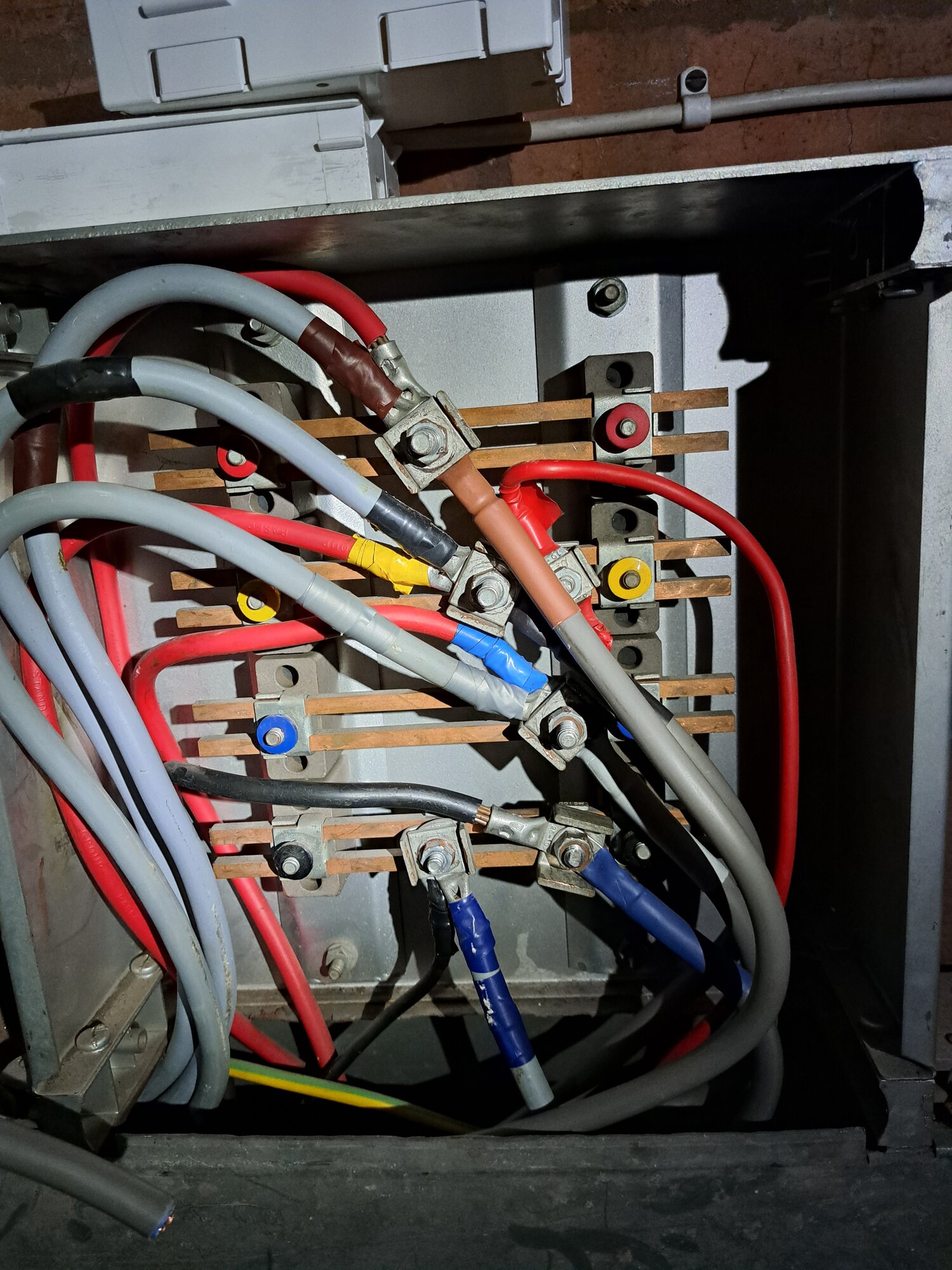

Picture of inside the Bill bus bar chamber.
[ElectriciansForums.net] Thoughts please, SWA vs T&E
Can't remember who wanted it but here it is.
  • [ElectriciansForums.net] Thoughts please, SWA vs T&E
Oh, you do need the MEM clamps after all then!
Get two sets so you can seperate those lugs onto their own clamps. It might just be me but it annoys me seeing stacks of lugs on the same busbar clamp like that.
