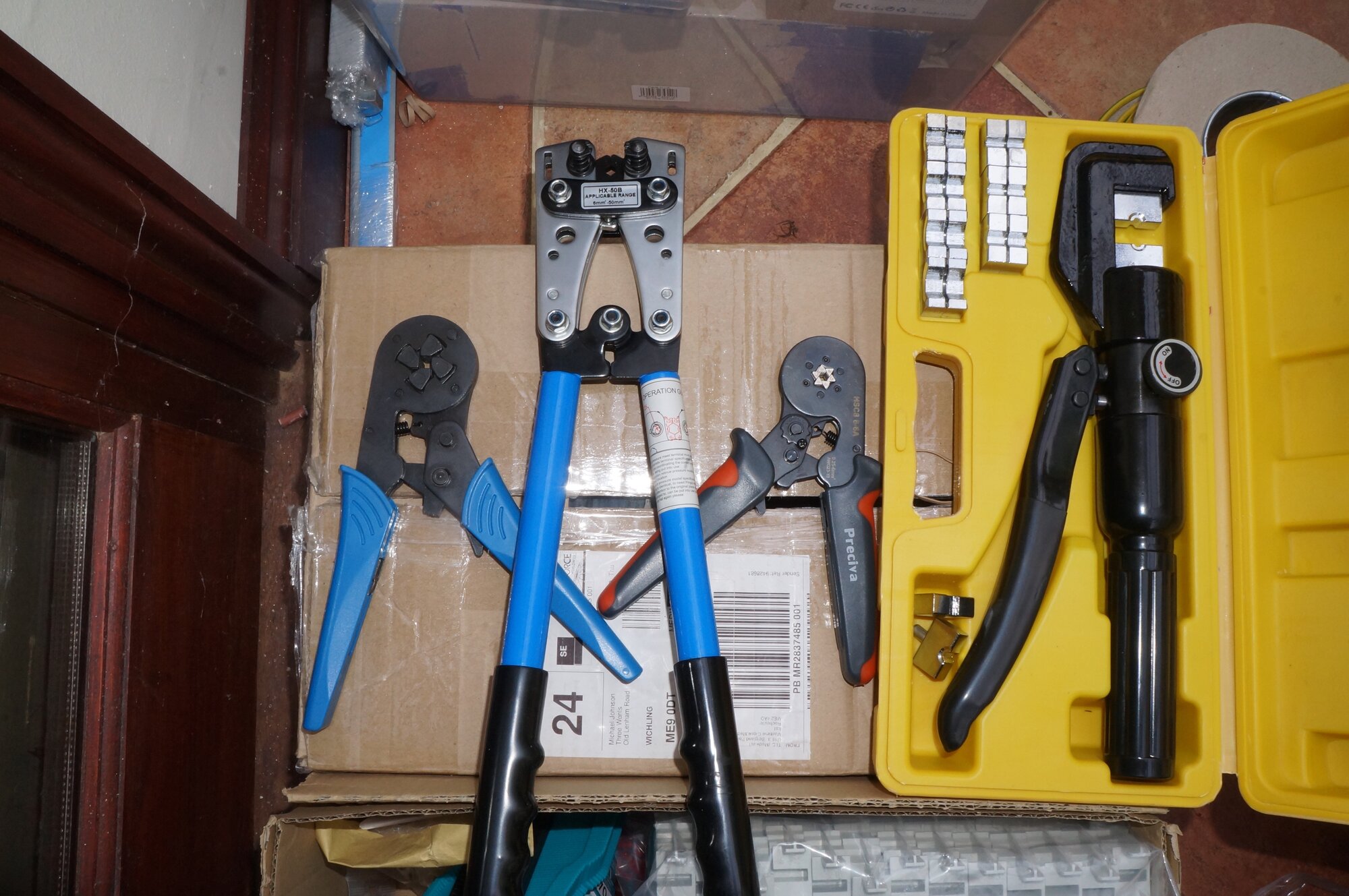

Anyone got any recommendations on a through crimp tool. A job I have been to look at the client wants the CU moving to a more convenient location, on the same wall but moving 0.5m to facilitate the kitchen design they have in mind.
Tails to the CU is fine its the rest of the wiring as I said I doubt there is 0.5m of play in the wiring. So would need to extend the cables. Largest size is 10mm T&E.
Was looking at this tool on Amazon:
Ratchet Crimp Tool
To use with these through crimps (covered with heat shrink after and placed into some trunking if I can't fish through to the new location.
Through Crimp
So before I go ahead and buy the tool I thought I would ask on here if anyone has any recommendations. I mentioned using adaptable box, din rail and din rail connectors. But the client wants minimal boxes and would rather some 4x2 trunking to the CU than box, trunking and CU.

It’s for a 10mm T&E cable on a 50amp circuit. It needs crimping and junction box isn’t wanted as client wants minimum boxing etc. Wago is no good as highest they do in that type connection is 41A for the push fit. 32A for spring loaded.

so it's uninsulated 10mm crimps with a couple of layers of heat shrink.

My opinion is that that hand ratchet tool you link to won't deliver nearly enough meat for 10mm crimps. More leverage needed IMHO.
With disclaimer that I don't own either of them, but at the budget end of the market I'd have thought that either this hydraulic set:
or this set with a lot more leverage:
Amazon.co.uk - https://www.amazon.co.uk/dp/B07L2S8FWR/ref=sspa_dk_detail_6
would serve you better. Of course others may have better suggestions. I tend to borrow a mates set and really should get a decent crimping tool!

CEW sell a nice SWA brand of crimps for £30
They're similar to the second set

Have you looked at the Wiska Wago relocation product. Different sizes available. Saves having to reinvent the wheel. CLICK ME
