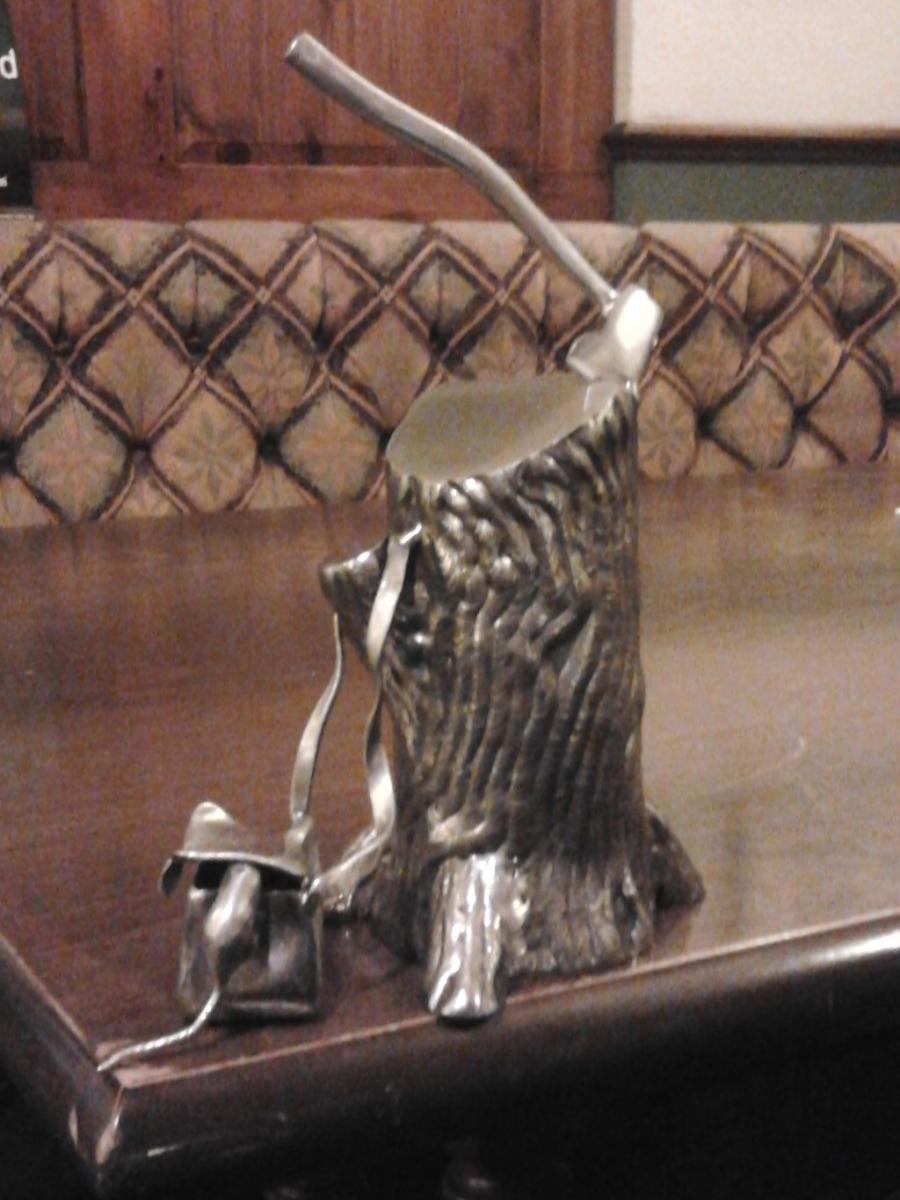

Here is a sample of my mates TIG welding. He made this from stainless tubing and scrap stainless.
Excuse the pic , done with fone in the Pub.

Lol , when you see that in the flesh you can see the intricate workmanship in it . He is a pro though , has and does work all over the world. He is never short of work.
