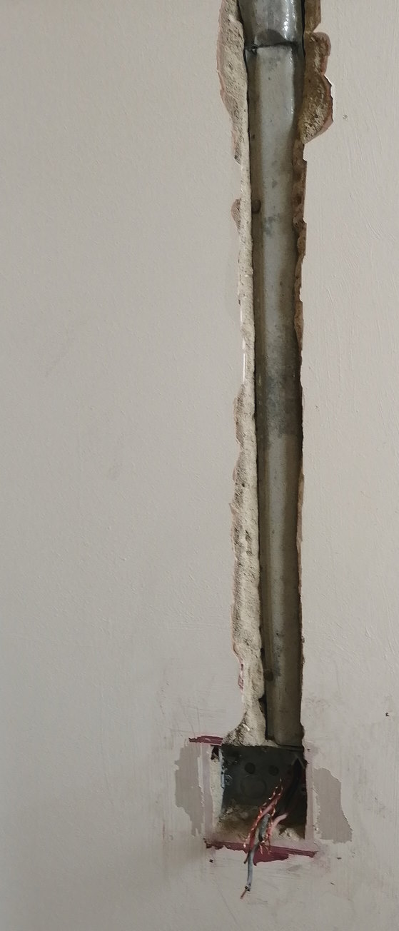

I have a two metre length of 2.5mm T&E running from the loft to a spur under galvanised metal capping (installed during building). Its needs replacing with some new cable ( long story).
As the cable is buggered, I decided to see how much force it would take to budge it, and it appears to be around three elephants worth. I really don't want to remove plaster and capping, refit etc.
Tips would be welcome !
Unsure exactly where in the run, buts it has a break somewhere.
If the cable won't pull out then I reckon a nail could have gone through the cable as they tried to nail the capping on the wall
The cable is going to be replaced so it does not matter if you destroy the existing, try using the bare core earth as a saw from both ends back and forth, then try pulling one of the cores then the other, then the sheath, you never know you may be able to get 1mm or 1.5mm single cores in the 2.5mm T&E space, check the loading on the spur.
To minimise the repair work try cutting through the capping and cable at a mid way point and then pull from both ends. Good Luck.
An old boy once showed me that trick and it works like 90% of the time
If you can't yank it out then you will have little chance pulling a fresh cable down it
Get the 4 inch bolster out and club hammer , time to mash off the plaster and see whats under neath
Remember to post a photo once you have mashed off all the plaster
Out and replaced, capping was crushed.
