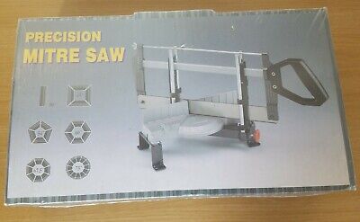

You could go in the middle and get a hand mitre saw!
But even a cheap chop saw is a very useful tool and fine for trunking with a fine toothed blade. As above make sure it does 45 degrees both ways or you have to cut half of it upside down!
