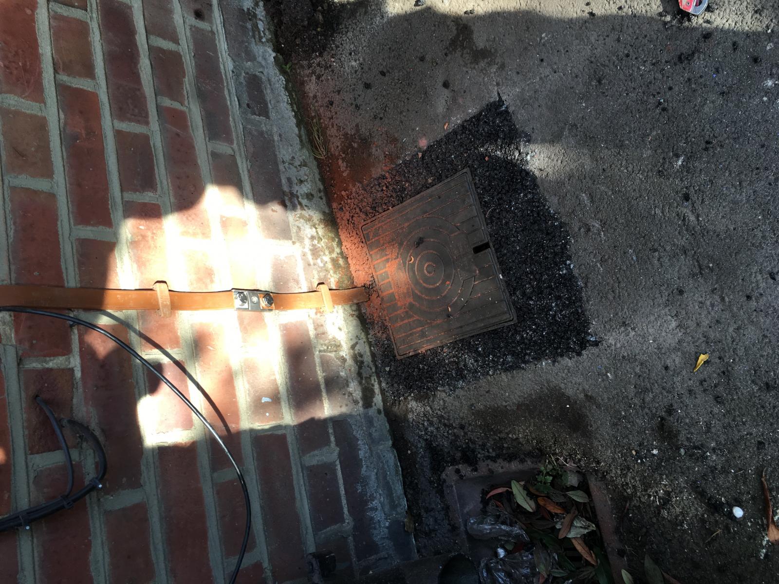

CAD welding for part of an earth nest. It's hard to get decent pictures of the work I do!!

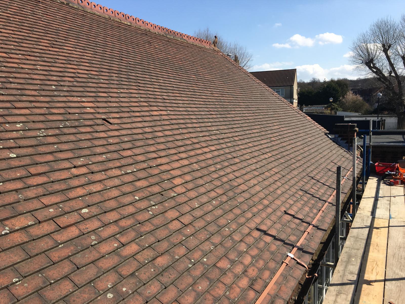

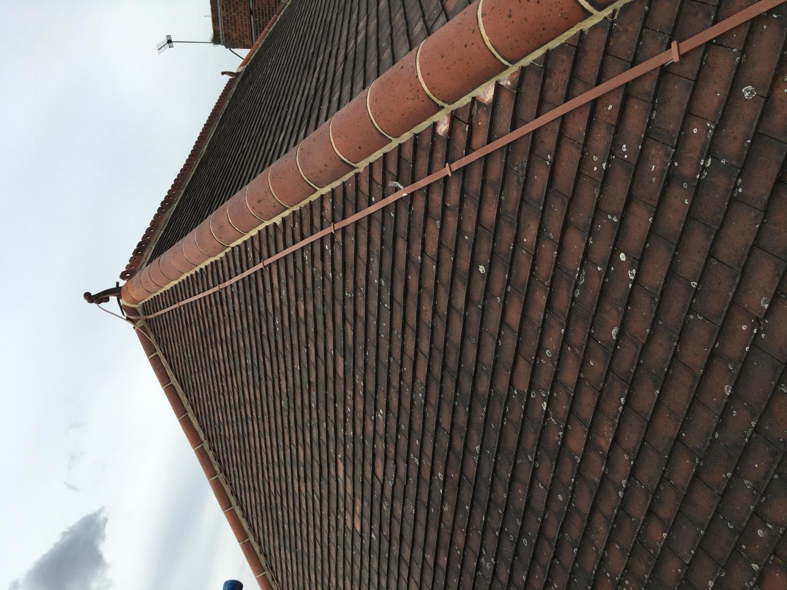

Pitched roofs don't half make your ankles burn. I've worked on many of them over the past year and half but this was the first job with rosemary tiles where I felt confident enough to get properly stuck in. I felt a whole new sense of accomplishment finishing this job knowing that I had been trusted enough to do so many crucial parts of it.

Do you have to carry out bonding to the lightning protection?
