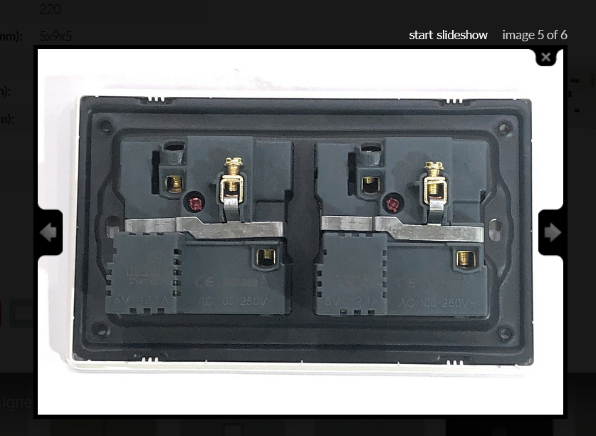

I recently installed about 10 (user supplied) Trendi Switch 2-gang sockets. When tested with a socket tester, 4 of them reported an earth fault on just one side only. I told the customer to take them back, which he did. However, when he replaced one of them with a new item, he got the same fault. After a bit of playing around he discovered that if you tighten down the unused earth terminal, the problem seems to go away. Haven't measured Zs yet to see if there is any difference, but this is the first time I have come across this requirement in a 2-gang socket.
I'm sure there was a similar post on here recently where the earth terminals had to be linked, may not have been a Trendi.
It sounds like the Trendi may have an internal link which needs the terminal tightened to make contact.
Update,
This is the back of a Trendi from their website, looks like the brass terminal which presumably is the earth pin on the front, is not directly connected to the link across the back and to the screw holes.
I'd guess the bar drops down slightly when the screw is tightened

Looks like you need to link the lives and neutrals as well?
silly design.
Indeed you do according to their own "technical" information - no continuity between L, N or E of 2 gang sockets.
