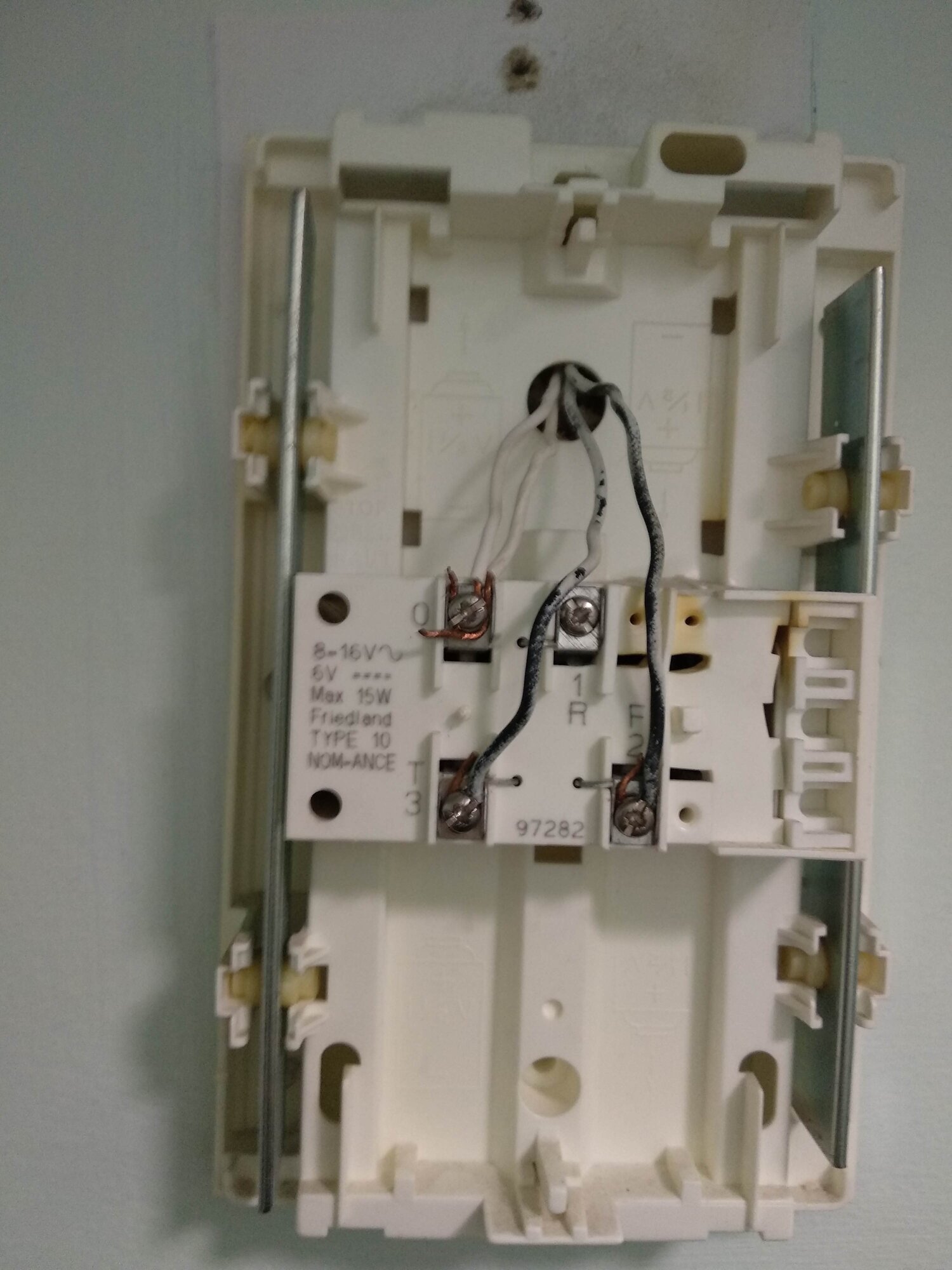

My chimebox was initially set like this:
[ElectriciansForums.net] Troubleshooting Smart Doorbell Installation - Pics + voltage checks inc.

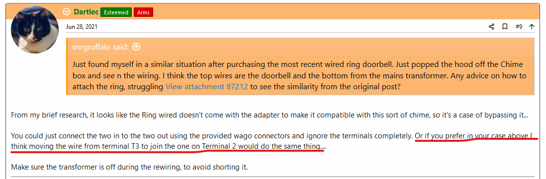

According to Lorex, their doorbell is not compatible with my chimebox. Therefore, I decided to bypass the chime completely. I didn't have a bypass cable specifically, but based on advice on another thread by the user Dartlec, I moved the Trans 3 wire and combined it to the Front 2 screw terminal. (Replace Friedland Type 4 chime transformer for Ring doorbell - https://www.electriciansforums.net/threads/replace-friedland-type-4-chime-transformer-for-ring-doorbell.195831/)

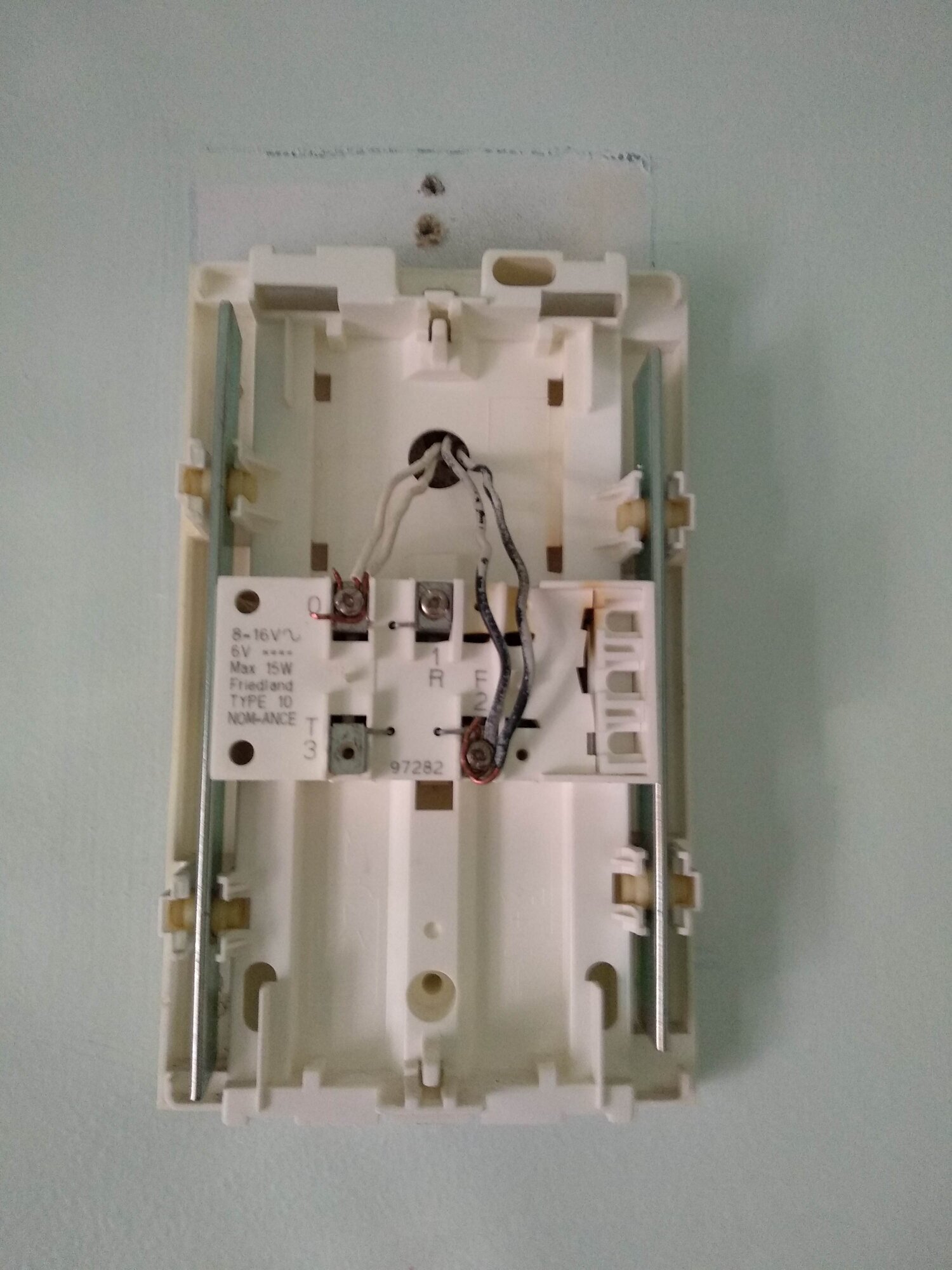

So now I set my chimebox like this: with the wires from T3 and F2 joined on one screw. As I mentioned earlier, all voltage reads 29v~ This time, when i check voltage between the O (top left) and Front 2 (bottom right) terminal, I still see 29v~

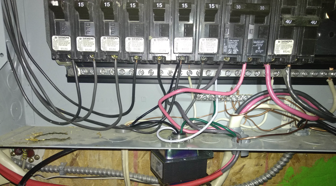

2.) Does the primary connection of the doorbell transformer make sense to you inside of the circuit breaker/panel? As you can see, the doorbell transformer is connected to another circuit (the washing machine). It's been like that since we got the house. I just want to check if the position of the black, white, and green wires make sense for the transformer.
