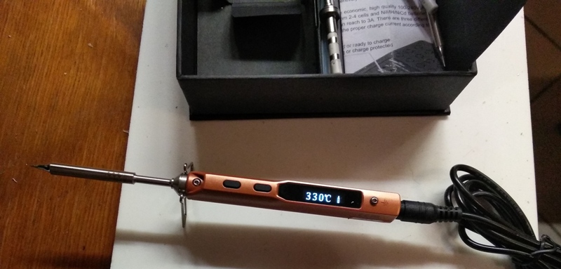

Just got my new soldering iron and I'm very impressed with it so I thought I'd do a quick review.
I've been wanting/needing a new portable and battery operated soldering iron for a while to do PCB small component and SMD work such as minor reflowing and component replacement.
I have a couple of battery irons already (Weller BP650 and an Antex that I can't remember the model no) but they're not great to say the least. The battery life is terrible, they're slow to heat, can't achieve a high enough temperature for many applications and their temperature stability is also appalling.
I've actually given up on battery irons years ago and just struggle with a gas powered iron for portable use but it's prone to causing collateral damage with the hot exhaust gasses through the tip and lack of temperature control and being too hot for small board work.
The iron is made in China but the build quality is very high. It's small but robust, the two tips that came with it are beautifully made and it's also supplied with an ESD wire that connects between the back of the iron and your ESD bench mat. They also include a small spring-wire stand that clips to the iron to keep the tip elevated when it's not in use.
Everything about it is great quality, even the box it comes in that has magnetic closing clips.

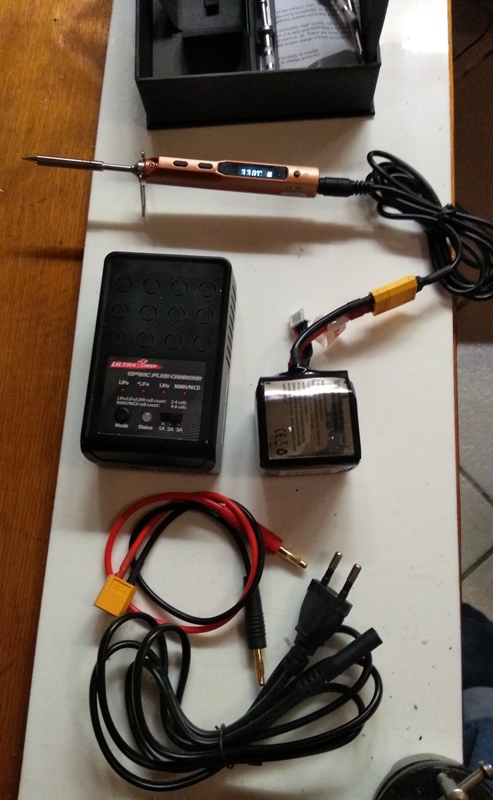

I should warn you at this stage that there's no batteries or any kind of power supply with this iron, it's just the iron, 2x tips, the ESD strap and the stand.
It will happily run on any DC supply between 12V and 24V so you can use it on your standard bench power supply or you can use a battery if you need to have it portable or on-site.
The power consumption varies depending on what voltage supply you use, for example at 12VDC it runs as a 17 Watt iron and draws around 1.5Amps. At 24VDC it runs as at 65Watt and draws around 2.7 Amps.
The heat-up times obviously vary with the voltage you use and are 40 seconds at 12V and 11 seconds at 24V to reach 300 degrees celsius which is extrordinarily fast by most standards. After using it on 24V from my bench supply for a couple of hours on and off I'd say it's at least as fast to heat up as my Hakko soldering station that I normally use, if not faster.
Primarily I wanted this iron to be portable so I also purchased a 4-cell LiPo 1550mAh battery and a small charger. The battery gives around 15 volts and the iron works perfectly at that voltage.
The battery and charger are nothing to do with the iron as such, I actually purchased them from a separate wholesaler that supplies anything to do with competition drones and hobby helicopters etc.

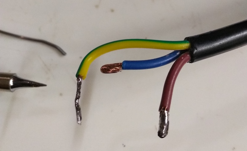

This is the job it did, whilst running off the battery, tinning some 1mm trailing cable ends and also a couple of resistors I replaced on a board. One of the wire ends was single thickness, the other was bent double.

The iron has an OLED display that gives indication on the actual temperature and whether it's heating up, cooling down or stabilized and pressing the buttons changes the set temperature up and down.
When the iron is connected to power it displays its logo followed by its firmware version followed by a little animation showing how to switch it on.
After a period of inactivity the iron goes to sleep. It must have some kind of built in accelerometer because if you pick it up or move it around it automatically wakes up and re-stabilizes back at the set temperature.
It has a USB port on the back of it to connect it to a laptop or PC which then allows you to change some of the pre-set perameters such as Celcius or Farenheit temp display, duration of inactivity that triggers sleep mode, sleep mode temperature etc etc etc. There's numerous other things that can be adjusted and the firmware is fully updatable and upgradable, there's even a calibration mode......I'm sure you get the drift.
It's maximum operating temp is 400°C which is more than high enough for any soldering jobs using leaded or lead free solder.

I'm usually pretty cynical and quick to find fault but in this case I'm very impressed by the whole package. I like it so much in fact I haven't even taken it to pieces and prodded around at its internals like I normally would with a new tool, I just want to use it.
Overall it would make a great soldering iron for general sparky use although you might want to invest in one of the larger bevelled or chisel tips that are available. I'd guess you could make solder and heatshrink joints on up to maybe 4 or even 6mm CSA wiring and it would be ideal for soldering LED tapes and other site work.
