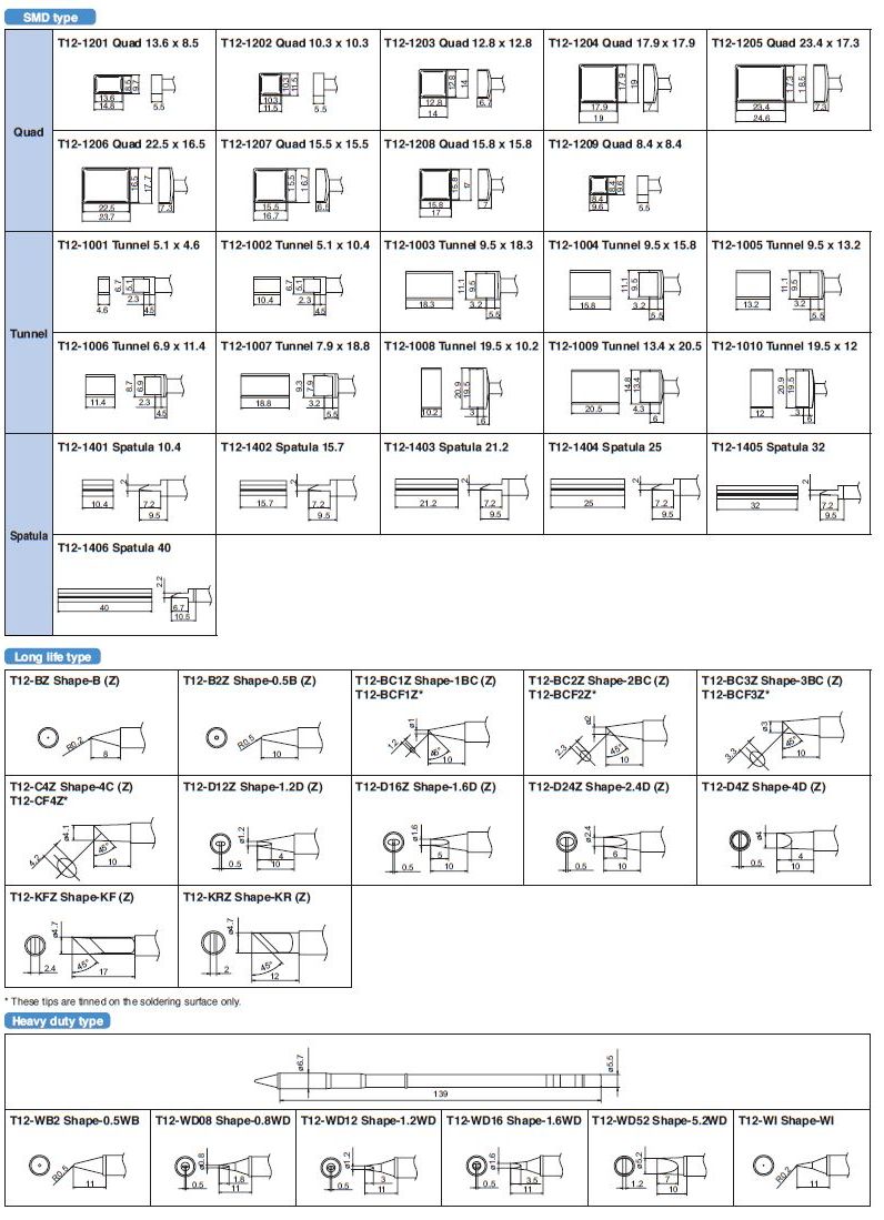

One good thing is that whilst the manufacturer only sells a very limited range of tips the T100 iron also works fine using the T12 tips from my Hakko soldering station. Whilst the T12 Hakko tips come in a very wide range, the only issue is that they're are around 50mm longer than the T100 tips so this makes them a bit awkward to use with the T100 iron.

Here's the range of general Hakko T12 tips available;
