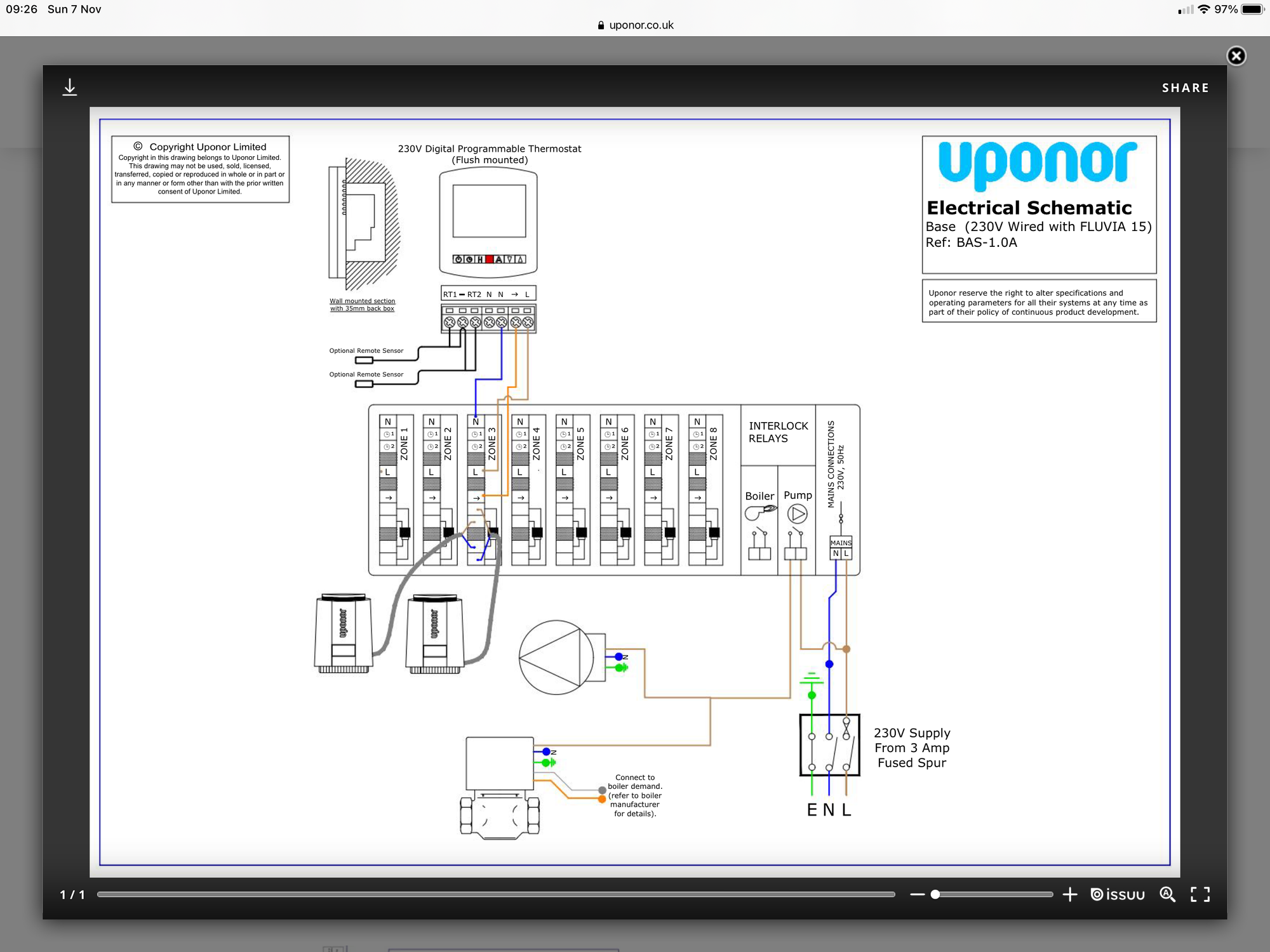

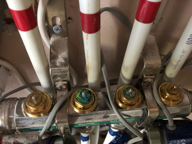

I have a gas fired underfloor heating system installed about 12 years ago. The controllers are Uponor C35 and thermostats T35 (there is also a UP36 mixer and outside sensor but I don't think that's relevant). There are two separate 4-port manifolds in different parts of the house. While doing some routine work. I noticed that when the thermostat calls for heat on one of the ports, not only does that actuator open but so does another - in the other manifold.
I can't figure this out from my limited understanding of how these systems work - I assume that the thermostat is essentially a switch and that it is only linked back to one of the C35s, so how can it affect the other?
