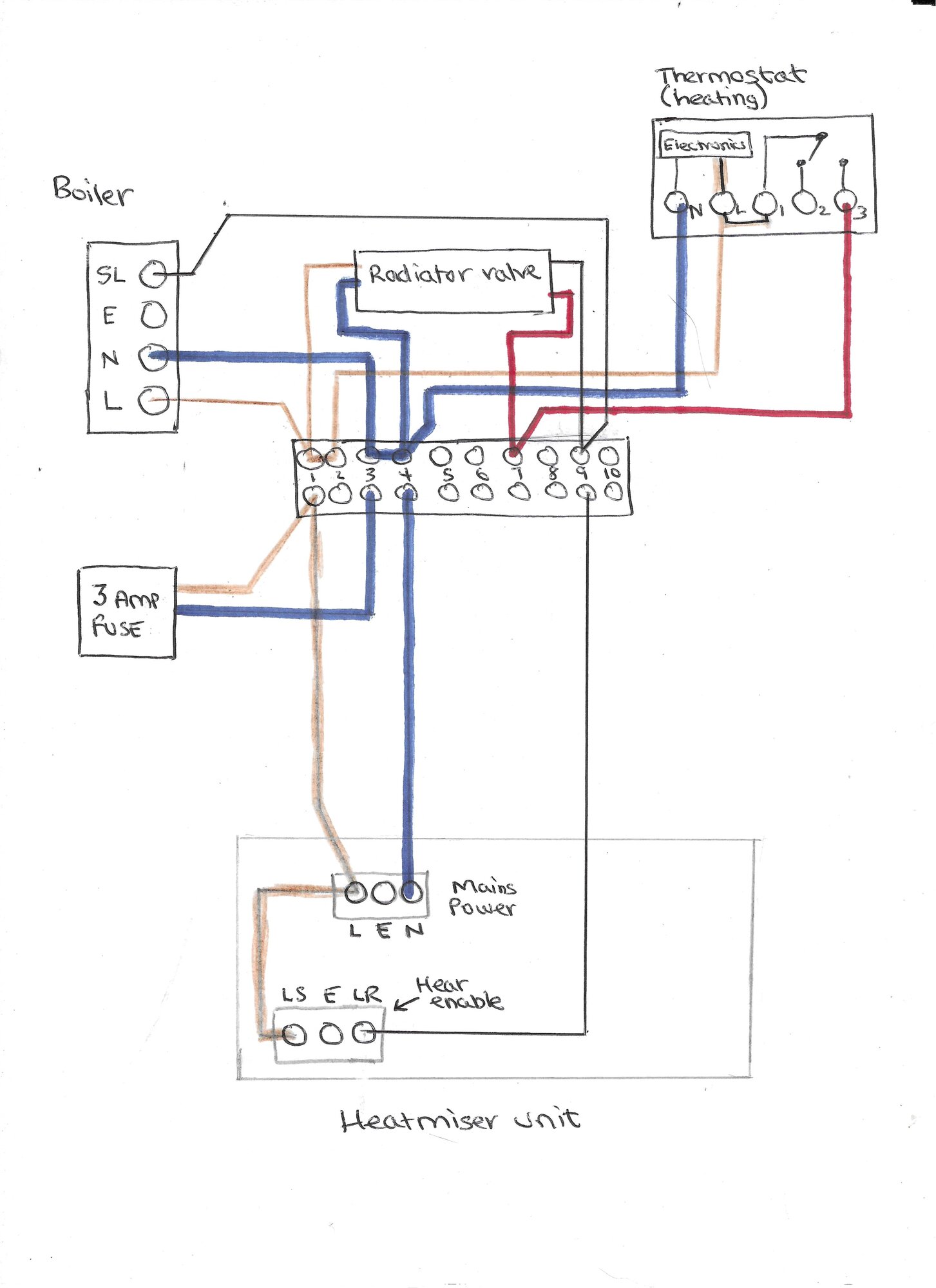

I think this wiring diagram would work.
I hope you don't mind me popping it up, so I can double check with you (or indeed anyone else).
That should work. If your heatmiser is calling but your radiator stat is turned down, the rad zone valve should be closed. No heat to radiators.
if your rad stat is calling but your heatmisers are not calling, then your heatmiser actuators should be closed. Seems to make sense.
The theory is right but the colours don't quite make sense.
Most 2 port motorised valves use brown and blue for the valve motor and grey and orange for the microswitch.
So in your diagram the grey of the valve would connect to your terminals 1/2, blue as shown to 3/4, brown to 7 and orange to 9.
The heatmiser box you have has the facility to connect the room stat and motorised valve for the existing heating zone, this is another option if it is going to be local to the boiler
