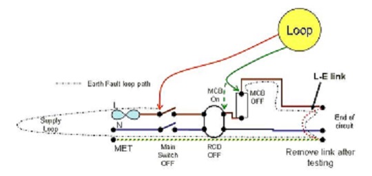

Been testing a modified circuit today.
Ze = o.20
R1 + R2 = 0.77
Zs = 1.77
So the reading is about 0.80 higher than I was expecting... Nothing on this (lighting) circuit switched on..... I was testing at the end of a smoke alarm addition.
I've read elsewhere, that its a good idea to do a Zs on the outgoing terminal of the RCBO to look for the "addition" this device is giving.
Is this correct? Anyone be able to point me in the direction of any previous threads, or guidance?
Thanks

I take it this was on a non trip loop setting?
I.e. 15mA test current?
Perhaps 'noise' on the circuit or the internal components of the rcbo causing it

Yes - non trip setting
Three-wire no-trip testing requires connections to be made to the live, neutral and earth conductors, and typically uses a test current of 15 mA or less. Its benefits are that there is no need to bypass RCDs and RCBOs during testing, which saves time, and that it does not trip MCBs. There are, however, a few limitations.
The results are not as consistent as those obtained with high-current testing, the instrument takes longer to make the measurements, the results can be affected by external factors; also the RCD internal impedance may occasionally affect the result. In addition, even though this is a no-trip test, it sometimes happens that existing and test earth currents add together to trip the RCD or RCBO.
These limitations only affect a minority of cases, however, and three-wire non-trip testing is the preferred technique for circuits protected by RCDs and RCBOs where access to the live, neutral and earth conductors is readily available.
Taken from the megger site.
If you need to then measure the Zs. However it is still accepted to add your R1+R2 to your Ze.
A lot of people are now being trained to keep live testing to a minimum to reduce risk. As long as you have Ze/PSSC/PEFC/phase rotation etc then you can use your dead test results to complete your paperwork.
once has a Zs on all circuits 350 ohms. suspected a TT with a crap rod, but investigation found that it was PME .Ze of 0.2 ohms.was an upfront RCD causing this. test on hi current this way.diagram courtesy of Richard Burns.:

TBH I'm so used to inaccurate no trip low current tests (they are the rule rather than the exception) that I'd just accept the result is way under the maximum for the OCPD and crack on. As already stated dead tests have verified low resistance R1 and R2.
Spending time farting about bypassing RCD's on one circuit may be viable. But if you've got a large installation to verify.....it's going to be a late one.

As previously posted, almost certainly due to differences in readings obtsined with high and low current measurements on the meter, low current...
